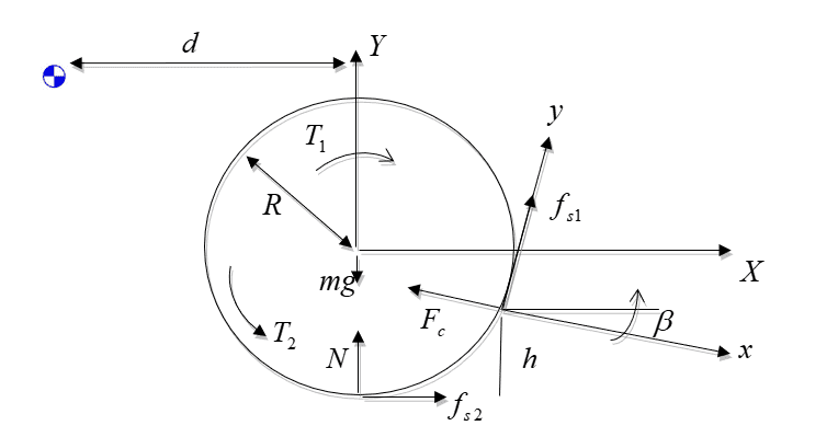

I've come up with this FBD. where:
T1 - given moment to front wheel
T2 - moment created after moving the whole weight of the chair to the center of the wheel
beta - hit angle between the wheel and the carpet
fs1 - friction with the carpet
fs2 - friction with the floor
Fc - Reaction force from the carpet
N - Reaction force from the floor
mg - weight of the chair and one wheel (actually m+M/4)
(the whole chair and the user weight divided equally to all 4 wheels)
h - height of a carpet
d - distance to the center of gravity of the chair and the user
This analyze led me to some ridiculously results.

danielp3 said:
This analysis led me to some ridiculous results
Do you want us to check your analysis ? If so, you need to post it ... :rolleyes:
Since ##mg## can be quite hefty, the torque around the edge of the step as axis of rotation can come out quite big.
I can post it of course, but I thought that maybe my approach is wrong, then all calculations will go wrong.
BvU said:
Since mgmgmg can be quite hefty, the torque around the edge of the step as axis of rotation can come out quite big.
The result I got is really high, I mean like 100+ [Nm] torque needed to the front wheels

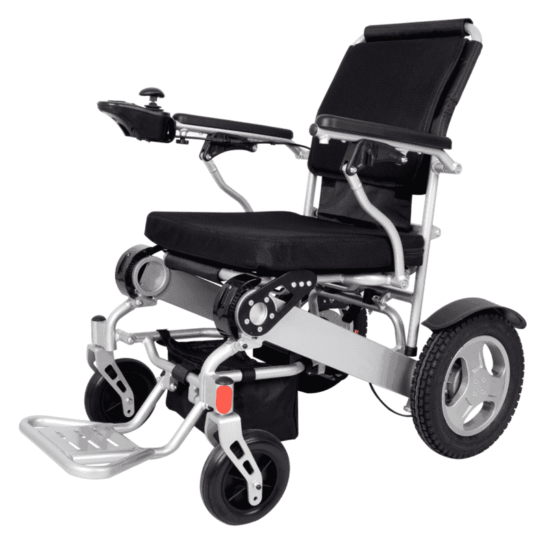

The motor I intend to use should be quit small to fit under a chair.
A motor with such power will be huge.
The situation is different for standard motorized wheelchairs. And yes, they have to be a bit heavy to accommodate the moderate-size motor (with low gearing) and the battery that lasts long enough to make the wheelchair useful.
EDIT -- Although this class of motorized wheelchairs that I found with a Google Images search doesn't look too crazy heavy. I wonder what it's specs are for battery life and climbing ability...

Seems to me you need to draw a much more complicated diagram to find out how much torque is needed on the front wheels to overcome a step: the rear wheels push against the edge hard enough to provide sufficient normal force so that friction is enough to let the front wheel torque tilt the whole chair. Position of center of gravity wrt rear and front axles is important for the amount of torque needed to tilt the chair.
