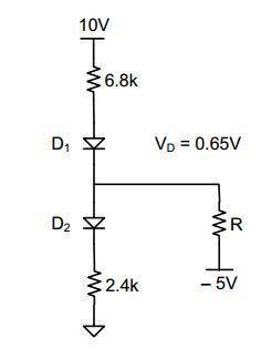

Use the approximation that the diodes conduct only at the indicated forward voltage. For what values of R is D2 Conducting and not conducting?
KCL
KVL
V=IR
I really am not sure how to approach this problem, as none of the ones we had done previously even remotely look like this. Could anyone direct me on where to start with this? Thank you.
