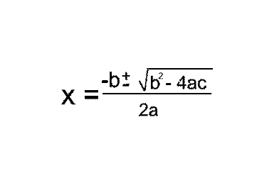

Your initial equation looks correct. Try solving it with the Quadratic Formula:
http://2.bp.blogspot.com/_V8KsSIiGj...AAFIU/vNtErLdchMw/s1600/Quadratic+Formula.gif
When ab = 0, then it is true that a = 0 or b = 0. But when ab = -10, it is not true that a = -10 or b = -10.
That logic can only be used when there is no constant factor. You need to complete the square or use the quadratic formula to find the values of t. The formula is much easier to understand and remember if you know how to complete the square.

I'm plugging (-15+sqroot(152+(98.0/3)))/(9.80/6) and getting ~0.644. Does that sound right? I'm really not too sure about that. And when I change the + to a - I get -19.011. Is there still something that I'm forgetting to do?
gldnsrfbord said:
Thanks guys, I guys a couple years away from algebra lead to me completely forgetting how to do it!
Doesn't look quite right. First of all, there is no 2x in the denominator. And the 2nd term inside the radical doesn't look right either. I could just be having trouble reading the equation without Latex, though.
