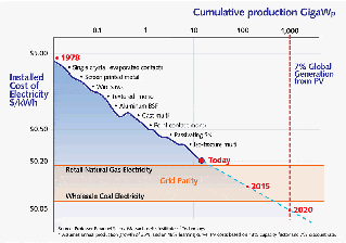

One EJ/yr (1e18 J/yr, ~32 GW-yr), possible non-fossil equivalent replacements:
  • Nuclear: 30 http://en.wikipedia.org/wiki/AP1000" reactors running at the US average ~93% capacity factor (or 15 of the common two reactor plants), plus transmission.
  • Wind Turbines: 32 times the one year increase in Texas wind capacity seen in http://www.windpoweringamerica.gov/wind_installed_capacity.asp" at 37% capacity factor ( or 32 * 1850 1.5 MW wind turbines), plus transmission.
  • Conservation: A 3.5% increase across the board cut in US electrical generation via load efficiency, generation efficiency, or both. (assuming a 900GW(e) average US electrical load)
  • Conservation: A 2% across the board cut in US petroleum usage through increased efficiencies such as higher vehicle mpg, or migration to electric vehicles (1 EJ = 167 million bbls oil, http://www.eia.doe.gov/energyexplained/index.cfm?page=oil_home#tab2")
  • Solar PV: 20 by 20 mile solar PV farm, 192 GW peak (225 W/M^2 mono-crystalline silicon panels, 1/6 capacity factor).

If the US share of the decline is say 1 EJ/yr then it appears to me that via some combination of the replacement scenarios I put forth https://www.physicsforums.com/showpost.php?p=2810804&postcount=25" that replacing that loss rate is feasible.
You're completely ignoring costs. The question isn't whether we can replace the energy, but at what cost? You're also completely ignoring the rest of the world. The United States doesn't exist in a vacuum.
The price of oil is due to shoot up dramatically in the coming decades due to the combination of flat or declining production coupled with increasing demand as more of China and India get "developed," along with other such countries. Even if the United States is able to make a successful conversion away from oil in the next couple decades, how about India and China? Will they have the resources to reconfigure their economies? What happens to the world economy when oil is $300 per barrel?

No, I'm focusing on one part of a very large problem at a time, a part I happen to have some familiarity with. That's how one generally solves problems. The costs of most of the replacements are roughly known. Meanwhile, introducing nationalistic 'what about the rest of the world' lines derails the discussion.

I have been trying to compare the cost of expanding solar to rising fossil-fuel costs. Assuming oil and coal prices keep rising, the cost of solar should decline relative to non-renewables. However, solar users who feed-in to their grid are wanting to receive the retail rate in exchange for fed-in energy. This means that there is no allowance for the utility company itself. The question is will utility companies charge more for oil/coal-based power in order to buy-in excess solar for the grid, or will the high costs and declining demand for non-solar drive the utility companies to bankruptcy?
