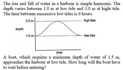

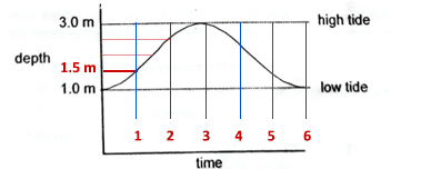

Please see the picture below
Simple harmonic motion
Equation for the tide:
$$y=-\cos \left(\frac{2 \pi}{6}t\right)+2$$
When ##y## = 1.5 m :
$$1.5=-\cos \left(\frac{2 \pi}{6}t\right)+2$$
$$-0.5=-\cos \left(\frac{\pi}{3}t\right)$$
$$\frac{\pi}{3}=\frac{\pi}{3}t$$
$$t=1$$
But the answer key is t = 2. Where is my mistake?
Thanks
How did you get from one line to the other? Show your work.
$$-0.5=-\cos \left(\frac{\pi}{3}t \right)$$
$$\cos^{-1} (0.5)=\frac{\pi}{3}t$$
Hm.
Ballparking suggests the textbook answer may be wrong.
But don't take my word for it; I'm just spit-balling, to jog your thought process.

I agree with your result (and with @DaveC426913). What textbook is this from?
I suspect that the textbook author meant to write: the time between successive low tides is 12 hours (not 6).
After all, there should be about two tides per day (in most places), not four! :-p
I think you're right.
This is question given by teacher
Thank you very much Doc Al and Mark44
