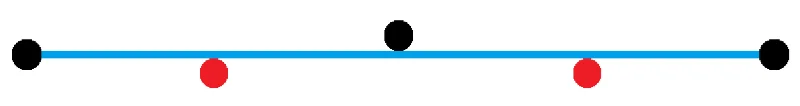

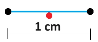

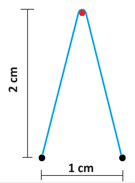

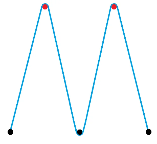

I interpret this as analogous to 'zooming' a view in an image. The coordinates are not changing but user's viewport is.
Except that it is not. Because there are things that do that change. For example: the length of time it takes light to travel from one coordinate to another.
If cosmological expansion were akin to zooming a viewport, then light would take the same length of the time to travel from one galaxy to another, no matter the 'zoom setting'.
Let's say the Virgo cluster is 65M light years way.
Let's say, in a billion years, it will be double that distance: 130M light years away.'
In your "viewport model", instead of the distance doubling, we are simply taking 1 billion years to zoom in by a factor of 2.
But if that were so, then it shoudln't change the lrngth of tiem of light propagtion. Light should still take 65M years to reach us from the Virgo cluster.
But that is not what our observations tell us. As things move apart the propagation of light is invariant. i.e. After a billion years, light really does take 130M years to reach us, and therefore it really is 130M light years away. That tells us the expanasion is real.
And a whole lot of other observations fall, if you assume the "viewport model", such as Doppler shifting and the Observable Universe boundary (there woudn't be a boundary in your viewport model).
