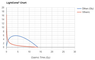

The two cosmological calculators mentioned can be used to produce the proper distance vs. time plot for the observed photon. I am thinking to outline the steps so that anyone can easily obtain the result. After that we can concentrate on the interpretation of the plot.
Output of Jorrie’s calculator is in tabular form and has Chart function; we will use it here. To get the proper distance vs. time plot for the observed photon, we can use the following steps:
  • Start the calculator: http://jorrie.epizy.com/Lightcone7-2021-03-12/LightCone_Ho7.html?i=1, it uses PLANCK Data (2015) as default input.
  • Leave the Upper row redshift, zupper at 1090, z value of the observed CMB photon, and change the Lower row redshift, z(lower) to 0.
  • Click Open Column Definition and Selection, keep only Cosmic Time and Dthen selected, and click Open Column Definition and Selection again to close it.
  • Select Chart and click Calculate. The Dthen vs. Cosmic Time plot will appear.
See attachment.

I argue that this plot gives us the proper distance vs. time relation for the observed CMB photon. Here is my interpretation:
The photon, started 41.6 Mly from our location around t=0.38 Myr, was carried away by the rapid expansion of space. It moved as far away as 5.84 Gly. As the space expansion slowed down, it turned around near t=3.9 Gyr and traveled to us, spending total 13.8 Gyr for the journey. The result shows one of the complicate consequences of the expansion of space.​
Please help to justify my argument and interpretation.
I mean, there's hardly a need to make an argument here, since that's pretty much literally what a light cone is, in those coordinates. Depending on the audience you'd want to reach, it might make sense explaining what a light cone is, and why a range of different emitters (we graph a range of z's after all) can be thought of as equivalent to the journey of a single photon.
Myself, I'd probably avoid describing it as 'turning around'. In local space, the photon always travels towards the observer. While for some of its history it recedes, and then approaches, it never changes direction - which is what turning around implies.As for embedding images, I usually just do a copy and paste, directly into the message box. Seems to work most of the time.
Some people, like me, learn things by having physical pictures in their minds. I cannot do reasoning using light cone and world lines yet. Maybe you can start a new thread to explain those things or give references such as light cone 101, etc.
About treating D(then) vs. time plot as proper distance vs. time plot for the observed photon, in my mind, I am thinking about a relay race: a new photon taking over the ‘baton’ is like emitting a new photon at that location and continues the journey. I think Jorrie’s D(then) vs. time plot does that for us.
You have a good point. Instead of saying 'turning around', maybe I should describe it in the following way:
The photon, started about 41.6 Mly from our location around t=0.38 Myr, was carried away by the rapid expansion of space [see the V(then)/c vs. Time plot shown below]. It moved as far away as 5.84 Gly until the recession velocity at the photon’s location reached V(then)/c=1 near t=3.9 Gyr. Then the proper distance of the photon started to decrease until it reached our location.​
