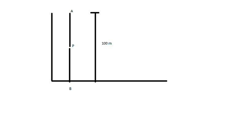

Let A be the point from where the first stone is dropped. Let B be the point from where the second stone is projected. Let the balls meet at P after time t has elapsed. So, then AP + PB = 100. Let v and u be the speeds of the first and second stone respectively. So,
1/2gt2 + ut - 1/2gt2 = 100
So, ut = 100 and we get t = 4s.
Is this correct?
  • Diagram of a vertical tower of height 100 m with a horizontal ground line; point A at the top of a shorter vertical line, point P partway down, and point B at the base of that line.
It's OK. You can do it this way too.
Actually this shows you that the two stones have a uniform relative motion.
As they both move with the same acceleration, their relative acceleration is zero.
@nasu Thanks. With this method I got the answer as 4s and distance 20m. Is the answer correct?
It's correct.
My method:
##100-\frac{1}{2}gt^2=25t+\frac{1}{2} \times -gt^2## also gives t=4s s=20m.
EDIT: I just realized that this is the same thing :shy:
