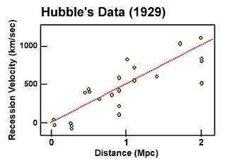

Hubble was first to notice that there is such a rate of growth. He noticed that a galaxy twice as far would recede twice as fast. In the same way as twice as much money in a bank will grow by twice the amount as it otherwise would. The discovery of importance here is not the amount of recession/growth (specific to anyone single galaxy only), but the overall rate of recession that can be deduced from those individual measurements.
The famous observation is represented by this graph:
where the circles are individual galaxies (nebulae, as they were classified back then).
The general trend of velocities increasing the farther away the galaxy is can be observed.
