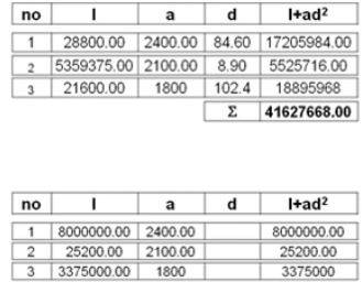

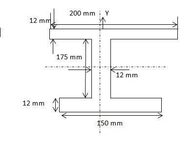

calculate the moment of inertia of this I section about centriodal
axis (##Y_{C}## = 108.4)
##Y_{C}## = 108.4
calculate the moment of inertia of this I section about centriodal axis (##Y_{c}## = 108.4)
245323
Where does ##Y_{C}## measurement goes in this I section?
calculate the moment of inertia of this I section about centriodal axis (##Y_{C}##= 108.4)
245324
245325
We can see d values at X axis is taken as 0.
How ##X_{C} = 0## in this diagram?
The diagram does not supply the relative x displacements of the three shapes. It looks as though you are meant to take them as all having their centres on the Y axis, despite appearances.
