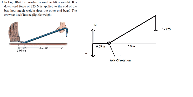

I am working on this word problem, you can see from my attachment..
I want to make sure my body diagram is correct?
  • Free-body diagram of a crowbar pivoting on a fulcrum, with weight W pointing down at the left end, normal force N pointing up at the fulcrum, and applied force F = 225 pointing down at the right end; lever arms labeled 0.05 m and 0.3 m, with 'Axis Of rotation' marked at the pivot.
I think that the normal reaction N would be at the pivot.
The rest of the diagram is correct.
