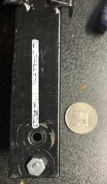

I want to do a straight metal cutting
I want to do a straight metal cutting, leaving a not too wide line whole in the middle (the filled white part) as seen in the picture. Does anyone know which tool would do this best?
Second the Dremel call. Take your time, let the speed of the tool do the work. Use either a rotary file on the Dremel and/or needle file(s) to clean up.
Unless you have access to a milling machine, the Dremel will be pretty much the fastest possible solution.

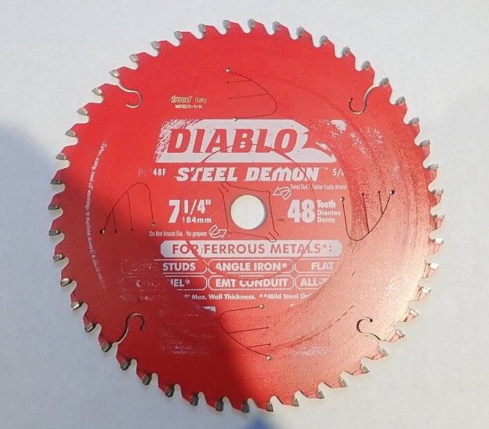

If you are cutting steel, and can tolerate a 2.5 mm kerf, a steel cutting blade in a table saw works very well. This particular blade has cut over 30 lineal feet of steel in various thicknesses up to about 3/8" in my table saw. Goggles for eye protection are required because hot chips fly. I clean the sawdust from inside my table saw before using because I do not want the hot chips starting a fire. Hearing protection also required because it's noisy.

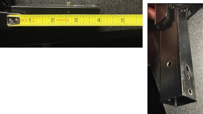

The issue I see is that he’s looking at a plunge cut in the middle of the piece, not a cut that can be made from the end of the piece. It also seems to be a tube/box section, not plate, and it’s unclear if the cut is intended for both sides.
@tirelessphoenix , can you show us another view of the piece that you wish to cut this slot into? Some dimensions will be quite helpful as well.
here it is. its a hollow square, not that thick
Chain drill then file. This will be tedious because the tube steel limits the file stroke. Take your time and drill carefully to avoid a wiggly slot. A dremel tool is faster than filing but it also makes faster mistakes if you're not well practiced.
Maybe there is a "maker" space nearby? They could mill your slot in 10 minutes.
I may be preaching to the converted but I have to mention the importance of firm workpiece holding (clamping) if you want to avoid 'wandering' of the cut and juddering. I really don't believe the YouTube videos where the guy does everything freehand and gets a perfect line and finish. I always suspect that there's a milling machine lurking somewhere in behind.
High speed and a fine tool will improve chances of a convincing finish.
