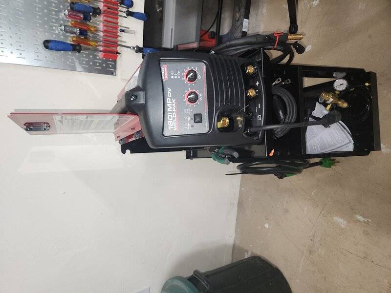

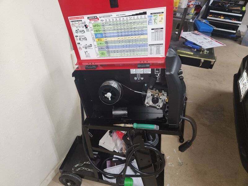

I have my welder and I have succeeded in wiring a 220V / 30A receptacle for it. I have threaded flux-core wire through the feeder, but not through the gun, and I have not plugged the gun in yet, the bare wire is sticking out of the front of the welder where the gun is to be connected.
I think, but have not been able to find any confirmation on-line, that if I leave the ground floating I can pull the trigger on the gun and the wire will feed but there is no way I will get an arc. But I'm a but concerned about verifying that by experiment - can anyone confirm that for me? I think the trigger closes the circuit to the wire feeder, and enables the high-power-path for the electrode, but if the ground clamp is floating the electrode won't spark, and its 'safe' to pull the trigger. Is this right?
Post a pic of the front of the welder.
Here is what it looks like. I might need to retract the wire, connect the gun and re-thread the wire to get it through the gun. I was just figuring out the side panel and loading the wire there, learning about how tightly spooled wire can spontaneously un-spool and other embarrassing rookie things.

Ok if it's the way I think it is, that little 'tail' hanging out on the front of the welder plugs into the + or - terminal and the ground clamp cable plugs into the other. With those left unconnected you should be safe.

@Grinkle Be brave.
MIG is only low voltage, about 24 volts DC, ± some small safe sparks to strike and maintain the arc.
Make sure there is a little friction on the spool, to maintain wire tension to the feed unit and prevent the wire jumping off the spool in use.
Plug in the thick wire feed cable with all the connections to the hand piece. Squeeze the hand trigger, so the wire feeds through. Then fit a tip that is 0.1 or 0.2 mm bigger than the wire size.
MIG is DC, with polarity dependent on the metal. So you will need to connect the ground and the wire feed to appropriate polarity on the front.
