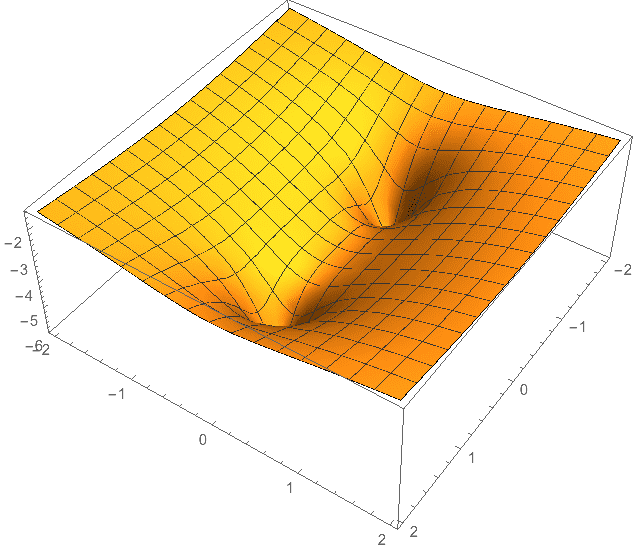

For whatever it's worth, here is a plot of the potential. The masses are at the corners of a square of side 2 units. The potential is displayed at z = 0.25 units and plotted from -4 to +4 units in each direction. At constant z there is no saddle point because of the fourfold symmetry.

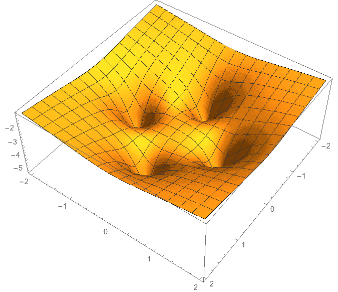

However there is a typical saddle point if the potential is similarly calculated in a plane parallel to ##xz##.
I am considering a "saddle" in three dimensions rather than in a constant z slice with only two.

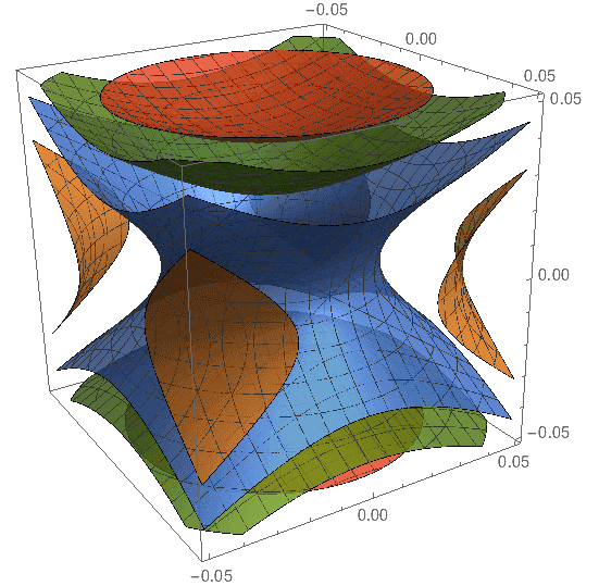

OK, this is the last one. It is the best I can do with 3D equipotentials and concentrates near the origin. Note that the side of the plot box is 1/20th of the side of the square. The smallest value (blue) equipotential shows the saddle point shaped like the neck of a carafe.
