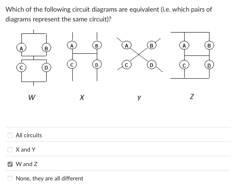

Which pairs of these diagrams represent equivalent circuits?

I(in) = I (out)
Hi, I came across this question and I wonder if my option is correct? I was thinking in Y and Z the current both divide (Kirchoff's Current Law) so they should be the same, while in X the current does not seem to divide and in Y I am struggling to visualise the division or current flow...
You get to pick more than one of the choices (and you should).
I think that, instead of considering Kirchhoff's current law, it would be easier to see what's going on if you considered the voltage law and that straight lines in circuit depiction represent equipotentials regardless of their shape. You can see that in all four diagrams one side of elements A-D is at the same potential. In W and Z the other side of A is at the same potential as the other side of B and the other side of C is at the same potential as the other side as D. Thus, as you have correctly concluded, W and Z are equivalent.
Now apply the same reasoning to X and Y.
You could start with the 'easy' feature: Y has four external connections but Z has only two. So can they be equivalent?
