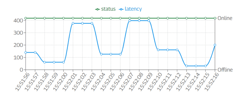

I've been bothered lately with an excessive number of freezes and dropouts when trying to conduct meetings on Zoom. As many as 10 freezes with 5 dropouts in 15 minutes.
I installed a tool to monitor my connection from my PC. In 4 hours, it gathered the following stats.
General stats​
Online for 0:13:28
Disconnects, today: 23
Availability, today: 98.78%
Downtime, today: 0:02:58
Disconnects, total: 23
Availability, total: 98.78%
Downtime, total: 0:02:58
Latency:
It also shows time plots of Online status and latency. The plot below shows the latency seen by my PC when downloading on my phone. Both share the modem and connection. Watching that plot, I have seen the latency go as high as 8000ms (8s) for periods as long as 30s. The dropouts, mostly seem to be preceded by long latency.
When streaming video, for example Netflix, the buffering seems to mask all such problems and no pauses or dropouts are noticed. But a Zoom meeting must be real time, not buffered.
My modem is Netgear, and it claims to be certified with up to 200 Mbps. My ISP is Xfinity/Comcast and I pay for 75 Mbps. They also offer 200, 400, 800, 1000, and 1200 Mbps speeds.

#1 might work if there is interference periods with Wifi.
Your ISP could have periods of heavy traffic itself.
Looking at the graph, it seems the latency follows a pattern of lengths 6 seconds, somewhat periodic.
Is that from the ISP's own system packeting, or something internal to your own computer ( or phone ) - ie a system interrupt to an internal system process. ie anti-virus program.
If so #2-4, shouldn't solve the issue.
With a VPN you are still going through your ISP and what you paid for.
Your paid for 75 MPS. You get no more. I imagine your ISP allows only a certain number of packets to be sent to you. If you pay for more speed, you get a higher packet rate.
throttling - since there is only so much wire ( bandwidth ), heavy usage when everyone connects at the same time and wants to download movies exceeding what the ISP can provide through the wire, everyone's speed drops lower so everyone can share equally to some extent. Not deliberate throttling, but due to hardware limitations. An upgrade to the ISP's system would be in order to keep clients more happy. That may or may not be your problem.
You can perhaps try use tracert during periods of latency to see if you can get a fix on what link the latency is introduced. If tracert never reveals the high latency link it may be a protocol or bandwidth problem. That said, bad wi-fi is a very likely candidate for latency, especially if you need to stream data and there is a lot of other active wi-fi access points nearby (as shown when you do a wi-fi search from your computer or mobile phone) or other sources of electronic noise.
Also we are getting close to Xmas, kids are getting out of school, people are ordering stuff online, medicare final countdown all happening during the day, nighttime people streaming, kids playing games... so the ISP may be portioning out internet service.

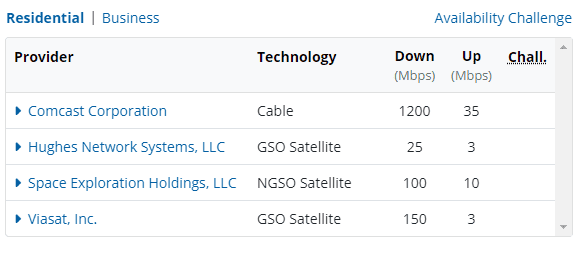

anorlunda said:
Use a different ISP?[/S] (not an option at my location.)
You should check out https://broadbandmap.fcc.gov/home to see what's available at your address. I discovered a few options that I never heard about at mine.

Unfortunately latency ties directly to your throughput in bits per second.
How to Calculate TCP throughput for long distance WAN links
If you have a good signal to noise ratio, you could try to increase your TCP window size,
but the larger the carrier, the larger the amount to resend if an error is detected.
if it were me, I would try the direct cable first, that would eliminate the WiFi as a factor.
I do not think the VPN would help, as it will add overhead, and may still go through the same path.
There is a chance that a VPN would not go through the slow area, and your internet point of presents(where you look like you are coming from, has no long latency hops, but it is just a chance.
Good news. I followed the advice of many in this thread and changed my PC from WIFI connection to Ethernet. After 24 hours of use, zero dropouts, zero slow-downs!!! :smile:
Thank you all for the good advice.
