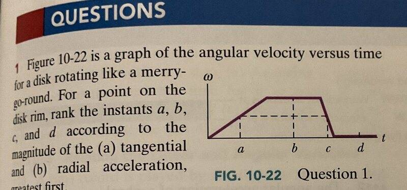

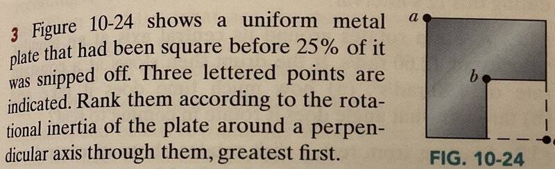

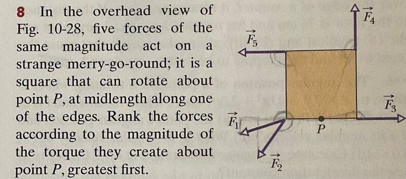

Before going into the test, I had done spent a good amount of time on these 10 concept questions at the back of the book in addition. Among these I had been able to solve 7/10 before going into the test. Here are 2/7 I solved:
My work for those questions:
A question similar to one of the questions I hadn't been able to understand and was challenging for me (despite searching it up and asking for a friends help) had been this one (I drew the reference line from point p and then made the perpendicular line from the force to that reference line, but couldn't make sense of the angle):
I did have the opportunity however to talk with my teacher about some of those concept questions (including this one) and I'm clear with them now. We only started the chapter on Friday and we had a 3 day weekend so that prevented me from consulting with my teacher earlier.
I think I know now that I have this platform to reach out for any questions I need help with, I just need to figure out how to manage my time to be ahead so I can ask questions well before the test.
