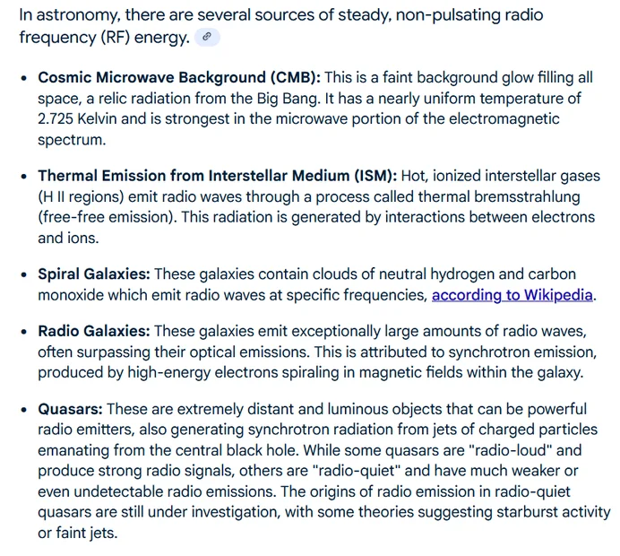

I can't find anything about such non-pulsating sources, even the Google search engine recognizes the query as incorrect, redirecting me straight to the query: "stable pulsating sources of radio emission". It is possible to determine that this is the same star as a pulsar by the spectrum of the emission and its intensity.
Seriously??? How hard did you look?

But what's interesting is that none of these sources are non-pulsating neutron stars.
Right. Also, none of them are pink unicorns either, but so what? Are you suggesting that there ARE no such things as non-pulsar neutron stars, or non-pulsars that do not emit RF?

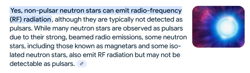

Answer from AI (may contain errors):
The Earth's magnetic pole is not attracted to the geographic pole, but rather is located near it, but does not coincide. The reason for this is that the Earth's magnetic field is created by the movement of liquid iron-nickel alloy in the Earth's outer core, and not by the planet's electric charge. This "dynamo effect" leads to the fact that the magnetic poles can be located in different points, but, as a rule, they are located near the geographic poles.
I will add on my own that, the magnetic field of a neutron star is obviously also related to its rotation, so rapidly rotating magnetars have the strongest magnetic field.
The magnetic field of the Earth is generated by a geodynamo. Most neutron stars never have a geodynamo. The exception is magnetars. They have a short-lived geodynamo that is so powerful it generates a superpowerful magnetic field that persists for millions of years.
