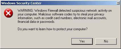

ok, I've been on the internet for some time now and have got used to locating and removing crap from the net that's got itself on to my PC. I now have Norton, Zonealarm, ewido and ad-aware, and i always have to keep going into the system folders, checking installed programs, looking at the registry and what processes are running.
But now I'm stuck with a few I can't get to ...
There are three messages. First there's the balloon (see balloon.jpg) that pops out from my icon tray. Notice that that word balloon is incorrectly spelt balloon. A file called balloon.wav keeps being created in the windows folder that provides the popping sound. I can't locate any processes i don't recognise, nor any other new dodgy files in my folders. On clicking the balloon i get sent to a windows security centre with a few antivirus titles at the side that don't go anywhere.
The second message is the "security centre" attachment. This comes up less often but is still something recent that i can't locate.
A third message I've yet to capture is more detrimental, because its tends to freeze the screen a few times. Although most often I can still do stuff with open applications (e.g. messenger) just not with explorer itself. Sometimes with this one I have to call up the task manager to restart my machine. The message states that a file I'm trying to open is not available, and points to a file called kernel.exe in the system 32 folder. I created a blank text file and converted it to kernel.exe. And it stopped, although I've yet to restart my pc, so not too sure yet. The difference in this third message is that this one actually appears as an application in task manager. When i click the process it leads to it goes to explorer.exe, which obviously I can't end.
Any ideas were these things are hiding?
Actually another thing, a folder called links keeps creating itself in my favourites folder. If could knock all this on the head, I would be very grateful.

  • #59
Download and run Spybot-Search and Destroy (preferably in Safe Mode with Network Support). After the usual scan, go to Advanced mode and check all the boxes in Tools. Add the Hosts file, and go to Startup, BHO's, and ActiveX and remove/uncheck anything that you do not recognize (use Spybot's right sidebar and Google to look up strange names). Check Windows Add/Remove Programs for strange entries before doing this. Startup is probably where you will find any remaining culprits that Spybot didn't detect. Do not uncheck the last few native windows processes in Startup. Restart into normal mode and use Firefox instead of IE. Make sure the latest Java and Flash plugins are installed.
  • #60
Looks like spybot has done the trick, ta very much for that. Some of the things it found i read a little about and looked in the registry myself and they look like what was causing the grief.
thanx again.
