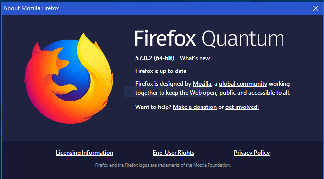

I like Serena said:
It appears that now Firefox is fast, lightweight, and non-invasive.
Seems a lot faster to me...
Screenshot of the About Mozilla Firefox dialog showing the Firefox Quantum logo, version 57.0.2 (64-bit), a status reading Firefox is up to date, and links for Licensing Information, End-User Rights and Privacy Policy.

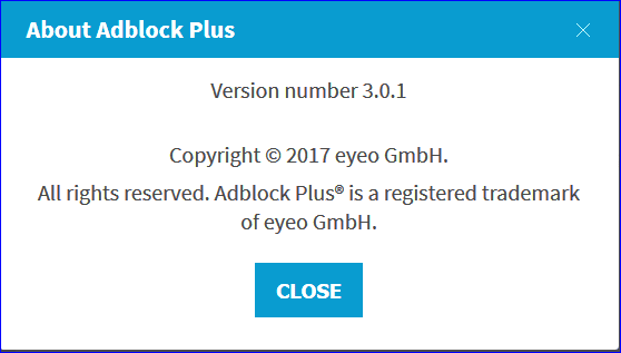

New Adblock Plus, also...
About Adblock Plus dialog box showing version number 3.0.1, copyright 2017 eyeo GmbH, trademark notice, and a CLOSE button.

  • Screenshot of the About Mozilla Firefox dialog showing the Firefox Quantum logo, version 57.0.2 (64-bit), a status reading Firefox is up to date, and links for Licensing Information, End-User Rights and Privacy Policy.

  • About Adblock Plus dialog box showing version number 3.0.1, copyright 2017 eyeo GmbH, trademark notice, and a CLOSE button.

I second I like Serena's mention of Firefox. It's a very different browser than it used to be.

Edit: @OCR I suggest ublock origin instead of AdBlock Plus. It does a lot more than ABP, for fewer resources consumption.
Thanks, I was tempted... however, I've used ABP forever, and I like Palant...:smile:

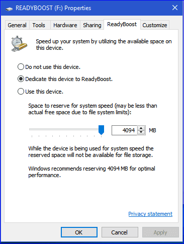

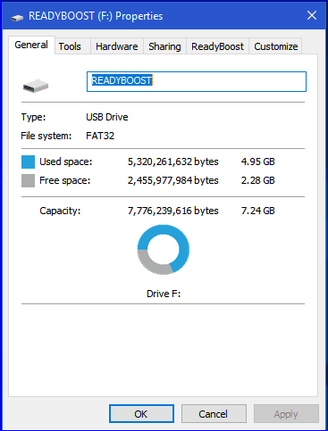

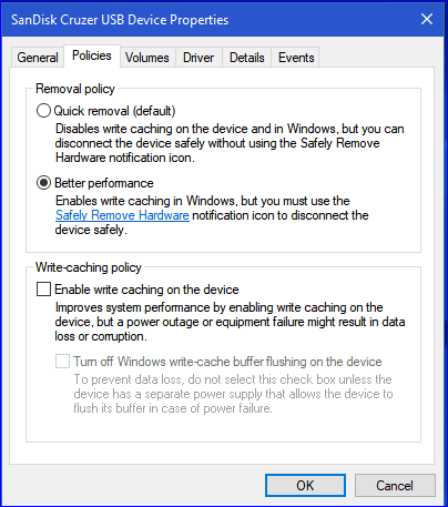

Jack, I don't know if it would help, but can you, or do you, use READYBOOST ?

Windows Properties dialog for a USB drive labelled READYBOOST (F:), General tab, showing file system FAT32, used space 4.95 GB, free space 2.28 GB, capacity 7.24 GB, with a pie chart of used and free space.
Windows Properties dialog for a drive labelled READYBOOST (F:), ReadyBoost tab open, with Dedicate this device to ReadyBoost selected and the reserved space slider at 4094 MB.
Windows properties dialog for a SanDisk Cruzer USB device, Policies tab open, with Better performance selected under Removal policy and the Enable write caching on the device checkbox unticked.
  • Windows Properties dialog for a USB drive labelled READYBOOST (F:), General tab, showing file system FAT32, used space 4.95 GB, free space 2.28 GB, capacity 7.24 GB, with a pie chart of used and free space.
  • Windows properties dialog for a SanDisk Cruzer USB device, Policies tab open, with Better performance selected under Removal policy and the Enable write caching on the device checkbox unticked.
  • Windows Properties dialog for a drive labelled READYBOOST (F:), ReadyBoost tab open, with Dedicate this device to ReadyBoost selected and the reserved space slider at 4094 MB.
No, I didn't know about this feature. Tried it, great! It made a huge difference. The flash game I was talking about is playable now on Chrome and a HD+ video plays with jerky images instead of stop and go intermissions. On the other hand, with Opera 12, the same HD+ video now plays flawlessly (it used to play with jerky images like on Chrome now). Yes, my slow computer enhances the flaws of modern browsers, but no matter the hardware, Opera 12 still out performs all of them speed-wise, which is weird.
But, on the very plus side of Readyboost, I now don't have problems anymore with my windows explorer. Once a folder is open, files appears instantaneously and even complex searches like words within text files, returns results instantaneously. I did one search on my entire computer for all pdf files and it took a relatively long time, but it finally returned a set, which was nearly impossible before as it seemed the search froze at some point.
So this thread was not written in vain.

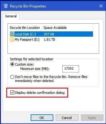

I was used to put files in the recycle bin and to empty it when its maximum size was exceeded (Upon deleting a file, I usually got a message telling me the file would be permanently deleted because the recycle bin was full). I never got such message since I have Windows 10 and thought it was maybe deleting automatically older files as you add new ones or something like that.
Well it doesn't. Even with a maximum size of 5.8 Gb (+ 3.1 Gb on the second drive), there was 18.8 Gb in the recycle bin! Stuff going back to 2013! The maximum size seems to be the maximum size of the file you can add to the recycle bin. A search on the net did not explain this change in behavior with Windows.
After emptying the recycle bin, my main drive (the one with all my programs including Windows) is now filled at 57 % of its capacity. :partytime:
