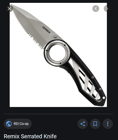

Can you say specifically which kind of serrated knife you are asking about, and what kind of materials you are cutting? There are differences between serrated bread knives, serrated meat knives and serrated utility knives that you would use to cut rope, etc.
Here is an article about serrated knives used in cooking:
https://www.cooksillustrated.com/equipment_reviews/1704-serrated-knives
And this is a typical utility-type knife with serrations for cutting ropes, seatbelts, etc:
Product photo of a folding pocket knife with a partially serrated silver blade, a black and silver handle with an open ring pivot, and the word GERBER printed on the blade.
