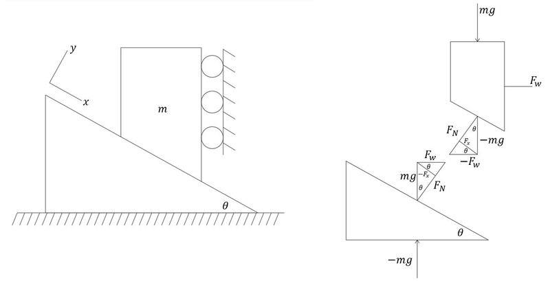

The force from the wall is not directed in your chosen x direction in the second example but you assume that it is.
F_x for the second case would be a component of the normal force between the wall and the block, correct? The way that I see it, the sum of the components, F_x and F_y for the second example should equal the normal force on between the block and the wall. Perhaps I am misunderstanding, could you please elaborate?
Incorrect. You can split all the forces into their components, but the force triangle is made by the normal force, the weight, and the horizontal force from the wall regardless of the coordinates you pick.
I think I understand - thank you for the clarification. I've included an updated diagram below to check my understanding. So in both cases, F_N=mg/cos(theta)? Why then is F_N=mg*cos(theta) if the wall constraint is removed?
Free-body diagram of a block of mass m on a wedge at angle theta, pressed against a vertical wall with rollers, with x and y axes shown; right panel separates the block, wedge and forces mg, F_N, F_w, F_x and theta.
After posting this reply, I now see that F_N is reduced when the wall constraint is removed, because no horizontal force exists, therefore the normal force only has to react to mg, and therefore F_N=mg*cos(theta).
Right, if you add a horizontal force, that force will have a component in the normal direction.

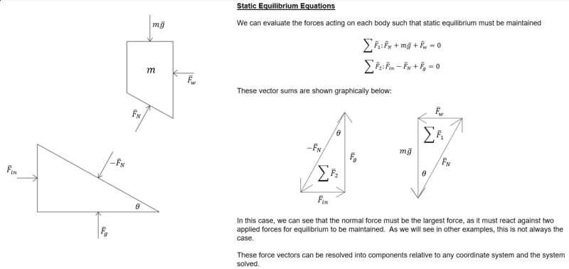

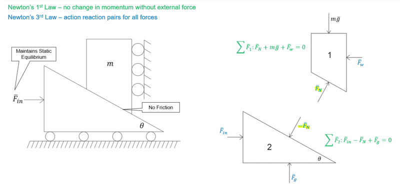

I have decided to add an addendum to this post in case others come across it - hopefully it will help build intuition and understanding as to why the normal force changes for different situations.
The first example is a "wedge", however the input force required to maintain static equilibrium could just as well be a reaction force if the wedge were grounded.
Two free-body diagrams: a block of mass m on a wedge with no friction, F_in pushing the wedge, wall reaction and normal force N, and separate force diagrams for block 1 and wedge 2 with force sum equations.
Free-body diagrams of a wedge and a block with static equilibrium force polygons: a block of mass m with weight mg, normal force F_N and wall force F_w; a wedge with angle θ, input force F_in, ground force F_g and -F_N; vector sums of forces shown as closed triangles.
Per the above sum of forces, we can see that the normal force must react against the wall reaction/input force and the weight of the object resting on the ramp. Therefore, it must be the largest force in the system to maintain static equilibrium. We can also see that the vector loop is invariant with respect to coordinate system choice - the components of the vectors can be determined relative to any coordinate system, and the magnitude of the forces will not change.

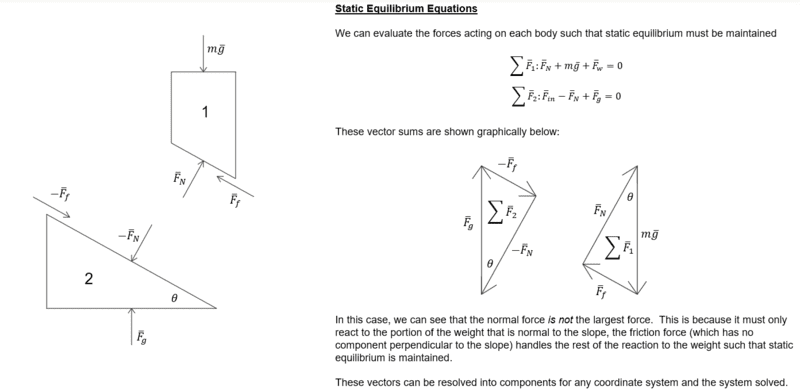

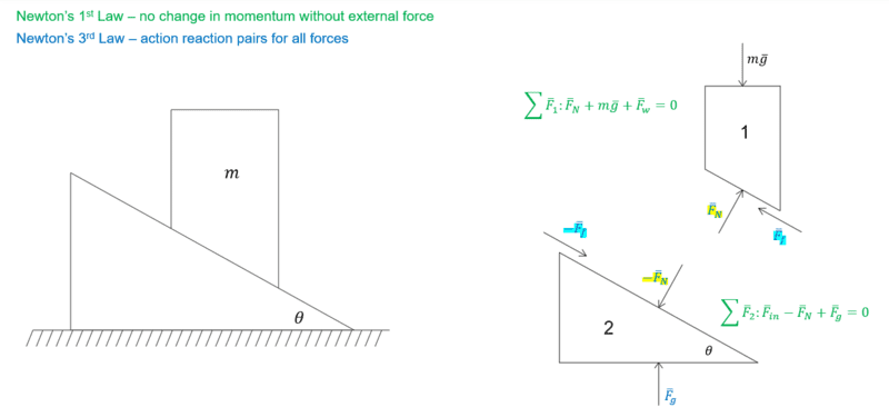

We can now consider a ramp, this time with friction as I feel that it is an easier system to grasp before moving on to a dynamic system.
Free-body diagrams: block of mass m on a wedge at angle θ on the ground, with the separated block (1) and wedge (2) showing normal force, friction, weight and reaction forces with action-reaction pairs in color.
Free-body diagram of a block labeled 1 with weight m g and forces N and f on its sloped face, next to wedge labeled 2 with forces -f, -N, g and angle theta. Right: static equilibrium vector triangles for each body, with sum F1 and sum F2.
Note that in this case, the normal force is not the largest force. It only has to react to the weight component that is orthogonal to the sloped face. The friction force (which has no component orthogonal to the slope face) handles the reaction to the rest of the weight to maintain static equilibrium.

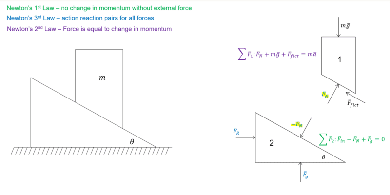

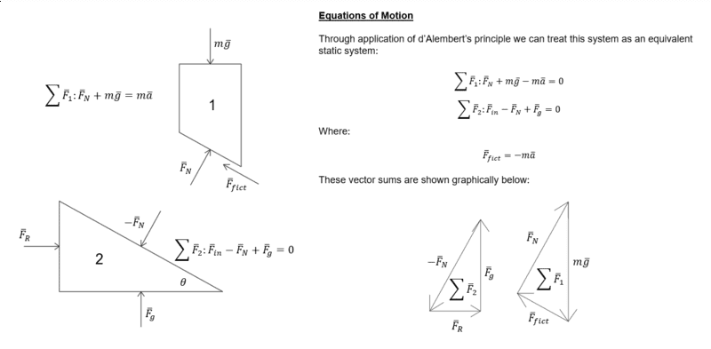

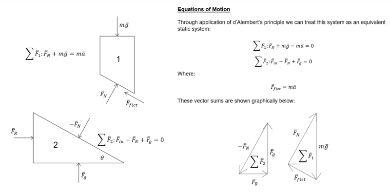

For the final case, we can analyze the situation above without the friction. With friction eliminated, we know from intuition that the block will slide down the ramp. However, in most examples the forces acting on the ramp are omitted from the analysis, because they are generally not of any interest. But in this case, I think it is worthwhile to show them.
Three-part diagram of a block of mass m on a ramp at angle θ, with force equations labelled Newton's laws, free-body diagrams of block 1 and wedge 2 showing N, friction, weight, and input force F_R.
Free-body diagrams of a block (1) on a wedge (2) with a vector polygon beside them; equations of motion using d'Alembert's principle, with labels for normal force, friction, weight and applied force.
I previously said that it was worthwhile to show the reaction forces on the ramp. This is because our result is interesting - for the ramp, the normal force is the greatest as it must "react" to the reaction forces caused by the fixed conditions of the ramp. However, for the block, we see the typical diagram that is shown, in which the normal force is less than the weight. Intuitively, this makes sense as only the portion of the weight normal to the slope face has to be reacted, while the "rest" of the force (that is, the component parallel to the slope face) is "used" to change the momentum of the block.
I hope this addendum is informative for those that had a similar question to the one initially posed. My issue was that I was taking shortcuts in not actually drawing out the forces and looking at the vector loops - I was trying to break everything down into components first.

The equations of the second case show a Fin that does not exist.
The drawings and the equations of the third case show a force of friction between both blocks that does not exist.
Lnewqban said:
Welcome!
Very nice drawings!
For the first case (which I assume you are referring to, as it is the only one with F_in), F_in is simply a force that is required to maintain static equilibrium since no friction is present in the system. It "exists" because it is prescribed by the problem, such that there is static equilibrium.
For the third case, the force that you are referencing is F_fict (fictitious force - arising from the implementation of d'Alembert's principle), but I can see how it could be mistaken as a friction force. If you look at the equations of motion, you will see that no friction force is present.
