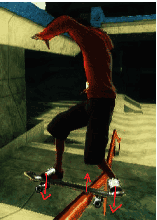

Thanks guys! And since normal force is an opposing force, would the normal forces in the picture be drawn correctly? I drew it in red.
The question is *Draw the normal forces that the legs of the skateboarder and the metal rail exert on the skateboard.*

  • Video game screenshot of a skateboarder balanced on a metal rail, with red arrows drawn on the board: two pointing down at the trucks and one pointing up from the rail to the board.
I don't like the question (don't know why not - intuition (*)?) but yes, that's what was asked.
(*) skater exercises a force on the board, and I suppose you can consider that a normal force.
Thank you for the reply BvU.
I am still unable to get hold of why the normal forces are pointing downwards for the legs instead of upwards as the force 'weight' would be pulled by gravity hence facing downwards.
