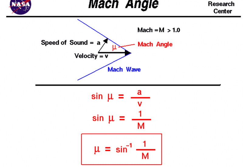

The vapour cone produced by high-speed aircraft is directly related to the Mach angle of its sonic boom. This phenomenon occurs due to the presence of expansion fans around the aircraft, which cool the gas and induce condensation when water vapor concentration is sufficient. The shape of the vapour cone resembles a cone due to the geometric properties of the Mach wave, as detailed in the Prandtl-Meyer expansion fan theory. Understanding these principles is essential for comprehending the physics behind vapour cones.
