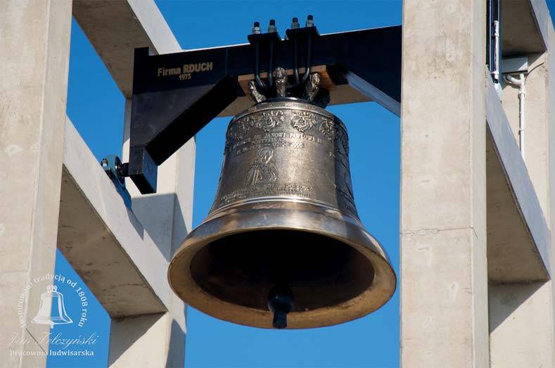

Why can't a bell be made smaller and smaller? :smile:
http://www.stthomaschurchbells.com/images/gallery/asia-church-bells.jpg

As a side note - the link is an EE site, right, but today I am mostly in sales, and have done a good bit of marketing. In EE we frequently work with analogies (Like Berkman's bell) and this is one case where our technical definition of communication has proven to be vitally important to me professionally...(Input Message-transmission-medium-receiver-Output Message - THAT is the objective - right?) It can easily be seen to add feedback to this model - and again, the exact basic feedback model has proven to be very useful to me in many roles - But to close this wired LOOP - think about how feedback could HELP or allow you to make an antenna smaller ( this is already done by the way).
