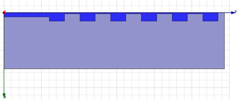

Hi :)
I am designing 6x1 series fed microstrip rectangular patch antenna by using HFSS.
The schematic of the my design is below.
Cross-section schematic of a series-fed microstrip patch array: a long light-purple substrate with six dark-blue rectangular patches along its top edge, joined by thin feed lines.
This figure is the half of my design for the past analysis.
My goal is below.
SLL(side lobe level <-25dB)
S11(<-20dB)
After I design the patch antenna, I found SLL around -20dB.
However, I want to reduce this value.
So, I check the internet & some papers and found some important parameters.
1. both width and length of patch antenna
2. length of the connection line
connection line is the microstrip line.
connection line exits between patch and another patch.
connection line has high impedance[100ohms].
I set the length of line L-2delta(L) {L is the length of the patch antenna}
And below is the parameters for antenna.
resonance freq = 26GHz
permitivity = 2.2
height of the substrate = 0.79mm
The values of effective permitivity, both length and width of the patch antenna
are below.

I found that the calculated values are not perfect value.
So I have changed the value such as width of the patch antenna, length of the connection line.
If the width of patch antenna is changed, length of the patch antenna also will be changed.
So, I use MATLAB tool then change the length of the patch antenna and effective permitivity.
These are MATLAB code.

First I set these values to my desin.
However, value of SLL is only around -10~-15dB.
So, I changed width of patch antenna to lambda/2.
And I changed length of the connection line to L-delta(L).
As a result, value of SLL is around -20dB.
FilesLink.com banner with the text "FilesLink.com" and "Free Image Hosting service" on a gray background.
To reduce the value of SLL, I change the length of the connection line to -0.01mm incremental.
However, the variation is a little.
How do I make smaller value of SLL?
If u give some advices or some references, it will be helpful.
Thank you~!
  • Half-model of a microstrip patch antenna in HFSS: a blue rectangular patch with rectangular notches along its top edge, grey substrate beneath, and x and y axes with an origin marker.
From what I remember in my antenna class, we've symbolically derived the pattern for array factor(I think), for specific size of an antenna array. Then, depending on the value of sidelobe value desired, appropriate filter coefficients were calculated to achieve the desired sidelobe values. These were equated to the terms in the radiation pattern. I used Chebyshev polynomials in the example below.
