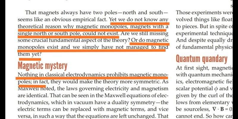

Oops! I found a piece of information (not sure of reliability) and in that they say even bout classical electrodynamics that nothing in classical electrodynamics prohibits magnetic monopoles.
Attaching the screenshot and if possible the pdf file too.
What they mean is that there is nothing mathematically inconsistent about a theory that changes classical electrodynamics so that magnetic monopoles are possible. But such a theory would not be the same classical electrodynamics that we currently have; it would contradict at least one Maxwell Equation (the equation ##\nabla \cdot B = 0## since magnetic monopoles would appear as a nonzero "magnetic charge" on the RHS of that equation).

Is there a theoretical reason why classical electrodynamics could not be formulated including magnetic monopoles?
Yes, that classical electrodynamics says ##\nabla \cdot B = 0##, which, as noted above, is inconsistent with magnetic monopoles. You could change classical electrodynamics to allow monopoles, but then it would be a different theory from the classical electrodynamics we currently have.

What they mean is that there is nothing mathematically inconsistent about a theory that changes classical electrodynamics so that magnetic monopoles are possible. But such a theory would not be the same classical electrodynamics that we currently have; it would contradict at least one Maxwell Equation (the equation ##\nabla \cdot B = 0## since magnetic monopoles would appear as a nonzero "magnetic charge" on the RHS of that equation).Yes, that classical electrodynamics says ##\nabla \cdot B = 0##, which, as noted above, is inconsistent with magnetic monopoles. You could change classical electrodynamics to allow monopoles, but then it would be a different theory from the classical electrodynamics we currently have.
This clears my every confusion. Thank you and everyone else who attempts to answer
