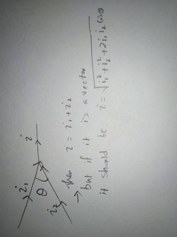

No..no...the full definition of vector is ...it should follow vector algebra...and It doesn't... example suppose you have 2 wires , with angle θ then the total current in the added wire should i^2 = (i1)^2+(i2)^2+2(i1)(i2)cosθ ..but as we know it is just i1+i2

The wire makes the direction of the current change, so you can't blindly use vector summation in that case.

Sir the in case of a planar conductor it should obey vector addition??...but practically it doesn't obey there also
The current inside wires is treated as a scalar because it is easier to work this way. In reality, it is a vector quantity that is always parallel to the wire, so there is not point in keeping track of the direction if it keeps changing but always follows the wire.
Take as an analogy a marble rolling in a bent tube. The velocity vector of a marble changes as it goes along the tube, but (neglecting friction), its speed is constant, so it makes sense to treat the problem using speed (a scalar) instead of velocity (a vector).

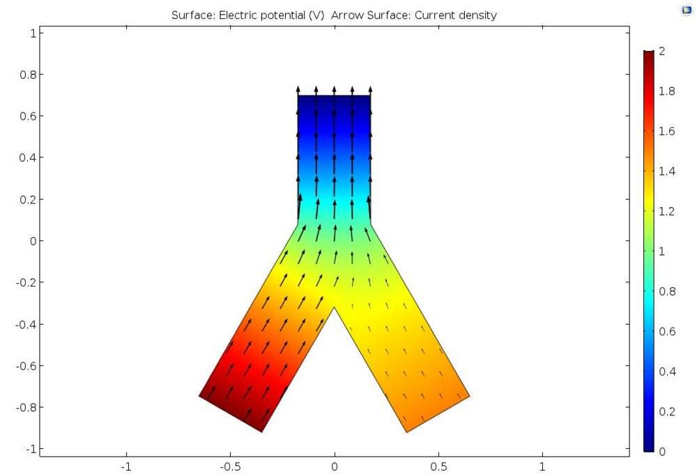

Here is what it looks like using your example of two wires joining into one.

Well, put simply, you ain't going to get far with electromagnetism if you persist with the idea that current is a scalar!
It's like saying velocity is a scalar because you've studied some 1D problems. A circuit is, essentially, a 1D set up, where the current is constrained to a 1D path. In general, in a 3D object, the current can flow in any direction.
I must say that I disagree with my colleagues and with Griffith.
Current density is a vector, but current is a scalar. As the OP correctly points out current does not follow the rules of vector addition. Also, in circuit theory there is no space so there are no directions, so there can be no vectors for any quantities in circuit theory.
What Dr. Griffith has actually written is the current density rather than the current. The current scalar is related to the current density vector by ##I=\int \mathbf{J}\cdot d\mathbf A##
