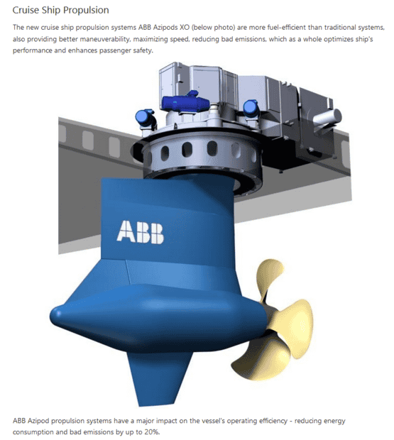

This ship uses "pods" - you have two independently rotatable nacelles under the waterline each with an electric motor turning the screw.
You want to avoid certain configurations, such as each impeller trying to push water into the other. I suspect - but do not know for certain - that they are discussing some kind of interlock that keeps this from happening.
And while it is easy for us on shore to be critical of it, it might well have kept a bad situation from becoming worse.

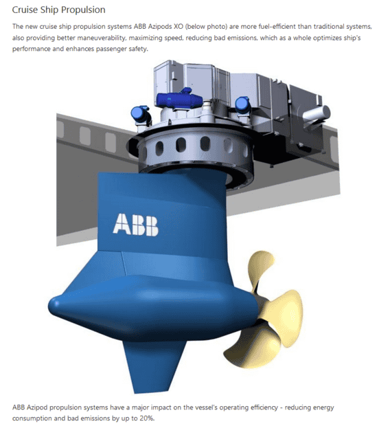

Yeah, interesting. It looks like Diesel-Electric Propulsion is common now, with the electric motors in the pods:
https://www.marineinsight.com/tech/cruise-ships-powered/View attachment 335059
https://www.cruisemapper.com/wiki/752-cruise-ship-engine-propulsion-fuel
Looks like a posh form of bow thruster. As there's one on either side, you could get a lot of twist if only one were to be lowered on its own - or operated at the wrong power and the wrong direction. Don't panic don't panic - klunk!!
Ye gods - what sort of gear box would do that without electric motors?

... you could get a lot of twist if only one were to be lowered on its own...
These don't raise/lower as far as I know.
Looking at the image again, that figures. I couldn't believe the power involved. Maybe they reversed just one drive. Perhaps a bit of panic?
