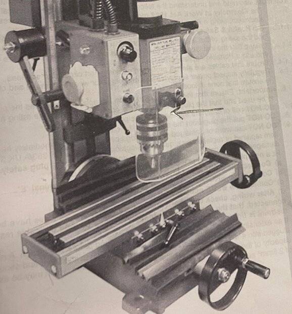

I have a mini milling machine (Sealey SM2502 aamof) with the tools held in an MT3. If I don't tighten it up well with the drawbar, the tools sometimes work their way out and the tool can rattle.
If I do it up tight enough to avoid that, it is very hard to release it and I use a rod with a soft end (not the draw bar because I don't want to hurt the thread) and give it a hard whack to release. This can't do the bearings any good and I want to do something about it.
I have tried model engineering forums but the opinions tend to be based on personal experience - although the guys want to help. I wonder if anyone reading this will have any informed ideas about the problem.
I wondered about buying a suitable reamer but they are expensive and the internal taper could be hardened.
Just posting this on the off chance that someone else has had similar problems.

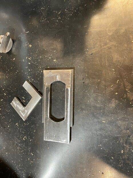

I'm just in the process of making up a pair of wedges to go between the bottom of the quill and the top of tools. It's only mild steel but it won't be 'bent' by its action - just could be gouged a bit. It's nice to use the mill to 'mend itself' with.
I will report back.
sophiecentaur said:
I will report back.
I used some gash steel plate to make a double wedge and, with an additional spacer, found that not too much force seemed necessary to release the taper by tapping with opposing hammers (no net vertical force on bearings). It's much less eventful than whacking with a hammer as the wedge has a small angle a couple of mm in 80mm.
Downside was masses of steel chips and some splinters in my fingers. but that's what you get with milling. Gimme aluminium.
I am cleaning, oiling and wiping more carefully now.
PS I measured the tapers on the two opposing wedges and they're about 3.5 degrees each. That means the hammers only need to provide about 12% of the force that a bash on the top needs and it two taps are more or less balanced

@sophiecentaur I'm having a hard time visualizing where the wedge goes. If it's not too much trouble, could you post a picture of it in action? Thanks! Just to be sure, you never apply the wedge when the drawbar is threaded tight, correct? That's the only way I can imagine it doing harm.
The oval hole between the two halves fits around the too shaft between the spindle and the top of the tool. (Not usually a drill chuck) There's only a few mm rise available but the extra U works for the collet holder. (see high tech pencil arrow) It works better and better as the faces polish up with use.
Haha!
OR without the draw bar as a safety net! So many opportunities to do damage on these machines. Teaching safe workshop practice to sloppy kids must be a nightmare.
