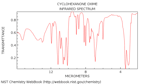

Yes, if you take an IR spectrum of a gaseous sample, you will see spectral lines that are somewhat broadened by Doppler effect and contain a rotational structure (which means that the lines actually consist of several closely spaced peaks). If the sample is a liquid or a solid, the interactions between the molecules increase the number of possible microscopic energy states so that the spectrum becomes continuous, like in the image below (but can still contain peaks).
