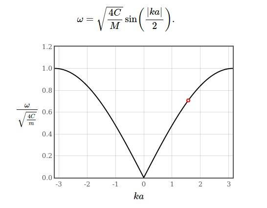

Modeling a solid as a 1D chain of atoms with Hookean bonds between them, the dispersion relation looks like
This is from http://lampx.tugraz.at/~hadley/ss1/phonons/1d/1dphonons.php
So the frequencies of the normal modes can't be higher than ##\sqrt{\frac{4C}{m}}##, with ##m## the mass of an atom and ##C## the spring constant. So it would seem that you need vibrational transitions where the ##n## in ##E = \hbar \omega \left( n+\frac{1}{2}\right)## decreases by more than 1 to get a visible photon emitted.
What you've shown here are acoustic phonons. It only applies to the charge from the nucleus. In real materials there will be optic phonons at higher energies.
But more importantly, in addition to the phonons, we must consider how the electrons can 'shake'. The relative permittivity ##\tilde \epsilon(\omega)=\epsilon_1(\omega) + i\epsilon_2(\omega)## determines how easily it is to shake (polarize) the electrons and lattice at each frequency.
From the relative permittivity ##\tilde \epsilon##, the emissivity can be found as a function of frequency with some straightforward algebra. Multiplying the emissivity by the ideal blackbody radiation at some temperature will give you the actual observed spectrum of a real body at that temperature.
Thanks. The usual way to derive Planck's law with statistical physics only tells the equilibrium amount of energy in modes of different wavelengths, but nothing about the mechanism how this equilibrium is reached..
Well then, just for completeness' sake, I'll mention that the electronic contribution to the relative permittivity arises from the electronic band structure and scattering mechanisms.
