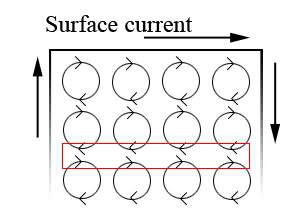

yoran said:
Allright. I have one question though. You say that you can see a magnet as having a current constantly flowing on its surface. Is that also physically true?
Why not?
When talking about magnetized materials, one common interpretation is that all the microscopic (i.e. atomic) magnetic momentums become aligned. If you could "see" the electrons orbiting the atoms, looking at them from the north pole you'd see all of them rotating counterclockwise.
Even if there isn't any electrical charge free of moving in the material, there is a net surface current resulting from summing all the microscopic circular "currents" (the orbiting electrons).
(here a picture would be great...)
You can get a mental image of those tiny loops "negate" their neighbors, so that there is no net current WITHIN the magnetized material.
But the loops close to the surface don't have neighbors, and therefore their "surface side" isn't negated and contributes (all in the same direction) to the overall surface current.
The magnetization surface current is not free... you cannot "extract" it from the magnet, it's BOUND to it, because it is not made of free charges.
I quickly drew up an image illustrating Domenicaccio's post above.
Diagram of a rectangular block filled with a grid of small circular currents, all circulating in the same sense; a red rectangle outlines one row, and a large arrow labelled Surface current runs along the top edge with arrows also on the left and right edges.
If you imagine the circles as tiny circular current, you can see that on the surface of the object, all the currents add up to one 'large' current.
Inside the object however (for example, in the red rectangle) the currents all cancel out because they flow in opposite directions.
