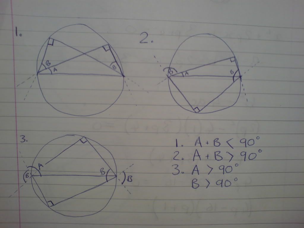

That's a good simple proof that I understand, but doesn't it only prove it for:
2A + B = 90 ?
**note: In the picture, I changed the letters, but it is the same concept. And the circle was just to help me get the right-angles right**
2A + B = 90 ?
Hi Georgepowell! :smile:
(can't see your new diagram yet)
No, I think that it works for any A + B < 90º …
and even for A + B ≥ 90º provided both A and B < 90º if you put R on the other side of the circle. :wink:
Yeah, the letters don't matter …
it's always best to use whatever letters you find easiest. :smile:
hmm … now you mention it, my own diagram (which you can't see :redface: would have been a lot better if i'd started off with a circle :rolleyes:)​

Georgepowell said:
Doesn't it only prove it for:
2A + B = 90 ?
I incorrectly presumed it was symmetrical, and so SQO = POQ.
Another misstake in the diagram is in the top left corner i wrote "OS = cos(B)" but it doesn't, OS = cos(A).
Actualy i think it works for all values of A and B, as long as neither of them = 90 exactly...
http://i349.photobucket.com/albums/q390/Georgepowell77/DSC00056-1.jpg
[edit] does it still prove it for A or B = 90? - I'm not sure[edit]
uh … i never noticed that misprint … i was only looking at the top right corner, where you got it right anyway! :biggrin:
yes, it works for A + B > 90º too, but then your diagram turns into :smile: Kurret's
for A + B = 90º, i don't see how to adapt it … but that's just sin2A + cos2A = 1 anyway :biggrin:
