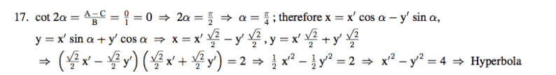

Textbook exercise instructions: rotate the coordinate axes to change the given equation into one with no cross product (xy) term, then identify the graph of the equation. The new equations will vary with the size and direction of the rotation used.
17. xy = 2
Handwritten-style worked solution: cot 2α = (A - C)/B = 0, so α = π/4; x and y rewritten using x' and y' with √2/2 factors, leading to x'^2 - y'^2 = 4, identified as a hyperbola.
Do you see that step where they do the following:
√2/2 - √2/2 = my answer is 0
and they multiply that to
√2/2 + √2/2 = my answer is √2
So to me the answer is 0 * √2 = 0, but the book shows that that calculation = 2, then they set x over 2 and y over 2, don't understand why.
I don't understand what the book is doing. I understand everything else except that one part.

do you mean the LHS of the equation at the beginning of the last line? :confused:
then you're ignoring the x' and y'
that LHS multiplies out to 1/2 x'2 - 1/2 y'2, which you can see is the LHS of the next equation
(and the RHS of both equations stays as 2)
are you saying they square √2/2 - √2/2? if they do that is still zero. I don't know what you mean by I'm ignoring x'. What x' am i ignoring.
they don't have √2/2 - √2/2 !
are we looking at the same question? :confused:​
all i'm seeing is something similar with x' and y'
They are NOT dealing with [itex]\sqrt{2}/2- \sqrt{2}/2[/itex], they are dealing with [itex](\sqrt{2}/2)x'- (\sqrt{2}/2)y'[/itex].
ok, thanks. I misread what I was reading I thought it was
(√2/2x' - √2/2x')(√2/2y' + √2/2y')
