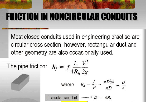

as we all know , D=4R , D=hydraulic diameter , in the equation of P= (8μLV_avg) / (R^2) , i would get (128μLV_avg)/ (D^2) , am i right ? why the author gave (32μLV_avg)/ (D^2) ?

yes , i know that . the object given is a long circular tube , so it is D=4R , right ? the notes is wrong ?

why the note gave 4R ?
They used the wrong formula for calculating hydraulic diameter to start with
##D_H = \frac{4A}{P}##
The rest is shoddy proof-reading and failing to catch the error.
I believe you are confusing radius with hydraulic radius.
The link from your original post mentioned R and D, with the implied relationship D=2R.
Your link in post #5 does not mention R, but Rh. This is the hydraulic radius, which is meaningful in any cross section, and does not equate to the actual radius in the case of a cylindrical pipe. Indeed, the way it is defined at https://en.m.wikipedia.org/wiki/Manning_formula would make it R/2.
Edit: to clarify, Rh=R/2 for a filled cylindrical pipe, and for a half-filled horizontal pipe.

so , D=4Rh or D=2Rh ?
D is the pipe diameter and is therefore twice the radius, D=2R.
Rh is defined as the cross-sectional area of flow, A, divided by the wetted perimeter, P. For a filled cylindrical pipe radius R, A=πR2, P=2πR, so Rh=R/2=D/4.
A half-filled horizontal cylindrical pipe has half the wetted perimeter and half the flow cross-section, so the same Rh.
In between the two, Rh reaches a maximum somewhere.

i have an example from my books ,
it stated that Dh= 4A / P , why not Dh= 2A / P ? since 2 radius = diameter ?

I don't know why hydraulic diameter and hydraulic radius are defined in such ways that the ratio is 4:1 instead of 2:1. My guess is that it is an accident of history and the two definitions (in terms of A and P) were made independently.

so , just follow D_h = 4A/ P ? R_h = A/ P ?
Yes. I suspect that you will not usually find both Rh and Dh used in the same text/problem. Authors will tend to adhere to one or the other. I could be wrong, though.
