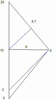

Al68
In the standard "twins paradox", we have a turnaround 8 ly from earth, v = 0.8c. Omitting the math, the ship's twin observes Earth's clock to "jump time" from 3.6 yrs to 16.4 yrs (adjusting for the Doppler effect). OK, this makes sense, since the ship's twin (instantaneously) switched frames from one in which he left Earth 6 yrs ago to one in which he left Earth 27.33 yrs ago, as determined from his (current) frame.
If the ship's twin can "see" the Earth clock "jump time" during the instantaneous turnaround, why wouldn't he "see" his own clock "jump time" during the (instantaneous) turnaround?

OK, let's say that a buoy passes Earth at 0.8c (at rest with ship) at t = 10 yrs Earth time, t' = 6 yrs ship time. How far apart are the ship and buoy before the turnaround, as measured in each frame?

The Earth observer will say the bouy and ship are 8 light years apart while the ship observer will say the bouy and ship are 13.333 light years apart. Note that at the same time the ship observer will say Earth and ship are 4.2 light years apart.
If I assume that you meant that "Earth at t=10 years" is an event on the buoy's world line, then I'm getting the same answers as kev: 8 light-years in Earth's frame and 13.333... light-years in the ship's frame.
Note that "Earth at t=10 years" is not the same as "Earth at t'=6 years". The latter is actually the same as "Earth at t=3.6 years".
Some details: The event on the buoy's world line that's simultaneous in the ship's frame with the turnaround event is located at (t,x)=(-7.777...,-14.222...). (Solve t=1/0.8x+10=0.8x+3.6 for t and x). A Lorentz transformation tells us that the coordinates in the ship's frame of this event are (t',x')=(6,-13.333...). The turnaround event has coordinates (t',x')=(6,0), so the distance is -13.333... light-years.

So how far apart are the ship and buoy in Earth's frame prior to the turnaround?
Thanks,
Al
Wait a minute. Does the buoy pass Earth at t=10 or t'=6? It's impossible to answer without knowing that. If you meant t'=6, kev and I both gave you the answer to the wrong question.
"Earth" represents a vertical line in the space-time diagram. "t=10" represents a horizontal line. "t'=6" represents a line with slope v (like one of the blue lines in my diagram). The Earth line intersects both the t=10 line and the t'=6 line, but not at the same event.
If you meant t=10, then we already gave you the answer. It's 8 light-years. This is very obvious. Earth is always at x=0, by definition of the unprimed coordinates, and the ship turns around at t=10, x=0.8*10=8, so the distance is 8-0=8.

I meant t'=6. The buoy passes Earth simultaneously (in the outbound ship/buoy frame) with the ship turnaround.
Thanks,
Al
OK, so the buoy passes Earth at t=3.6 years. At this time in Earth's frame, the ship is 3.6*0.8=2.88 light-years from Earth. Since the ship and the buoy move at the same velocity, the distance (in all frames) between them will be constant. So it's still 2.88 light-years in Earth's frame when the rocket turns around at t=10.
The distance in the ship's frame is 2.88/gamma=4.8 light-years.

OK, I'll try an answer. The ship turnaround is at t'=6 yrs in ship/buoy frame, t = 3.6 yrs in Earth frame. Since the buoy is at Earth and can observe Earth's clock locally, the turnaround event occurs at 3.6 yrs in Earth frame, 2.88 ly away from earth. After the turnaround, buoy is still at Earth moving toward ship. Ship arrives at Earth at t' = 12 yrs on ship's clock, t = 7.2 yrs on Earth's clock. Earth twin is younger when they reunite. Earth twin will observe ship's clock to run slower the whole time, but "jump" ahead during the turnaround, since it was not simultaneous (earth's velocity relative to the ship changed). I won't bother drawing a spacetime diagram, just switch the ship and Earth around on the diagrams all over the net.
You seem to have misunderstood how to do this (and maybe also what an event is). The turnaround is an event that has coordinates (10,8) in Earth's frame. The event (3.6,0) is the event where the buoy passes Earth. These two events are simultaneous in the ship's frame before the turnaround, but it's absolutely not true that...
The event (3.6,2.88) in Earth's frame is the event on the ship where the ship's clock shows 2.16 years.
There is only one turnaround event and it's at (10,8) in Earth's frame, at (6,0) in the ship's frame before the turnaround, and at (0,4.8) in the buoy's frame (if the buoy's clock is set to 0 when it passes Earth).

The event on the buoy's world line that's simultaneous in the ship's new frame with the turnaround event is at (11.40,6.24) in Earth's frame. Let's call this event Z. If we take the turnaround event to be the origin of the ship's new coordinates, then event Z has coordinates (0,-1.05) in the ship's new frame.
It will be a good exercise for you to try to obtain these results, but don't start with the calculations. The first thing you should do is draw a space-time diagram (from Earth's point of view) so you can see that these results are reasonable. You should think really hard about how to draw simultaneity lines.

It was the position coordinate that was negative, not the time coordinate. It's obvious from a space-time diagram that they will meet. The equations of the two world lines in Earth's frame are
[tex]t=\frac 1 v x+3.6[/tex]
[tex]t=-\frac 1 v x+20[/tex]
(with v=0.8). So they will meet at (11.8,6.56) in Earth's frame.

Al68;
The 'time jump' is not something perceived, but a fictitious
change resulting from a change of (pseudo simultaneous)
reference frames.
As mathienste said, the observer detects no change of his clock
(because it isn't moving relative to him).
Fredrik makes a good point of using a space-time diagram to
sort things out.
The included image shows the space twin perceives 2 yrs of
earth events on the outbound leg, and 18 yrs on the inbound leg.
If we allow an instantaneous turnaround, then the ship clock
still shows 6 yrs. and would catch up on the return trip.
You can also eliminate the turnaround by using two ships which
cross at the 8 lyr destination and synchronize their clocks.
