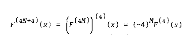

The first equality is easy: the ##(4M+4)##th derivative of ##F## is just the 4th derivative of the ##(4M)##th derivative. The second equality is false, in general, because there are many counterexamples. The ##(4M+4)##th derivative is usually not a constant (##= (-4)^M## ) times the 4th derivative.LauwranceGilbert said:mod: moved from homework
Does anyone know why and when this equation holds? I have searched online but cannot find the reason or the rules for the higher order derivatives.
