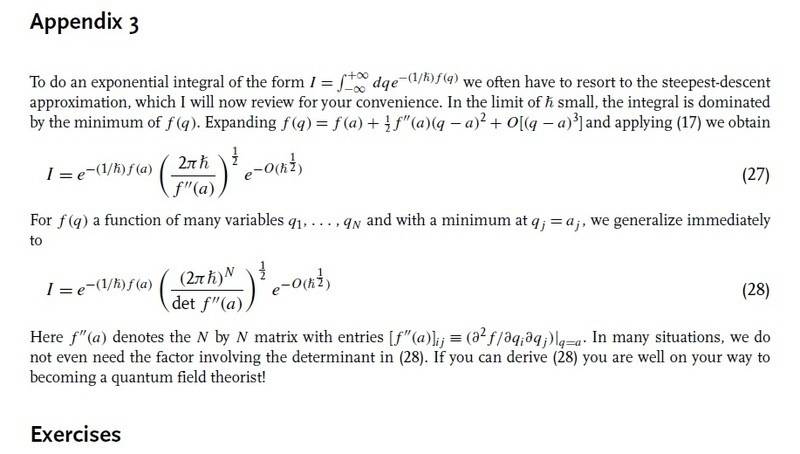

I'm reading Zee's 'QFT in a Nutshell' and I came to one thing that bothers me - he's short discussion of steepest-descent approximation. I've known this thing for quite a long time now, but I've never seen the approximation of the corrections. Here is what he writes:
[tex]I = e^{-(1/\hbar)f(a)} (\frac {2\pi \hbar}{f''(a)})^{1/2} e^{-O(\hbar ^{1/2})}[/tex]
Of course we take the limit in which Planck's constant is small, and that is where problem occurs. Because in this limit [tex]e^{-O(\hbar ^{1/2})}[/tex] will approach infinity, and that is not what it should be like, right? Any thoughts about this issue? I just think that what he wrote is simply incorrect.
I tried to derive this approximation by not neglecting the cubic termis in (x-a), and I don't even see why there is a square root of Planck's constant...

It is probably applied later in the book, but it firstly appears in the very begining. I made a screen of everything that there is about this issue, not that much though...

weirdoguy said:
So now, I still have a problem - how did he get this exp(-O(ħ1/2)) factor? Because I don't see why it is a square root of ħ...
For a reasonably well-behaved function f(q), the error in that Taylor expansion is going to be dominated by the last included term, ##\frac 1 2 f''(q_0)(q-q_0)^2##.
Look at ##\int_{-\infty}^{\infty} \exp\left(\frac{-1}{2h} f''(q_0)(q-q_0)^2\right)\, dq##. Sans some scale factors, that's just the Gaussian integral.

Well, I know, and I know how to integrate it. But still, I can't see why corrections are in the form of exponent with ##-O(\sqrt{\hbar})##.

weirdoguy said:
But now - I tried to see what will happen if we won't neglect higher order terms.
Don't look at those higher order terms. Look instead at the last term that was included.
In quoting just the last part of my previous post, you omitted the key point of that post. Once again,
For a reasonably well-behaved function f(q), the error in that Taylor expansion is going to be dominated by the last included term, ##\frac 1 2 f''(q_0)(q-q_0)^2##.​
You don't need to look at those higher order derivatives in the expansion of f(q) if that function is "well-behaved". By well behaved I mean that there exists some finite C>0 such that for all q in the interval of interest,
[tex]\left|\sum_{r=n+1}^{\infty} \frac 1 {r!} f^{r}(a)(q-a)^r\right|<C\left|\frac 1 {n!} f^{n}(a)(q-a)^n\right|[/tex]
In other words, for a well behaved function, the last included term in the Taylor expansion (in this case, the second order derivative term) bounds the error. If this is the case, that exp(-O(ħ1/2)) multiplicative factor falls right out.
