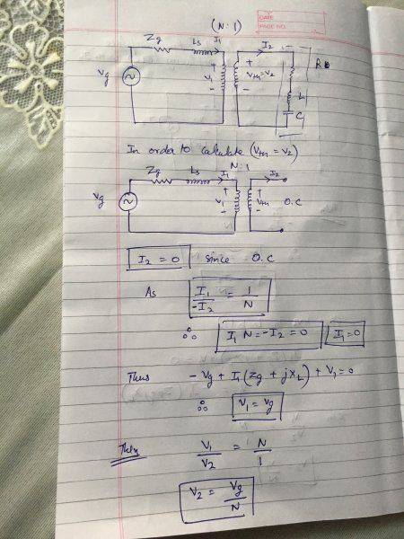

Q. I have to write an equivalent circuit for the transformer coupled RLC load.My answer is not matching with that of book . I am uploading my work and the answer given in book.
It is an N:1 ideal transformer.

  • Handwritten notes on lined paper deriving the Thevenin voltage of a transformer-coupled load: an N:1 ideal transformer with source Vg and Zg, and the open-circuit condition I2 = 0 giving V1 = Vg and V2 = Vg/N.

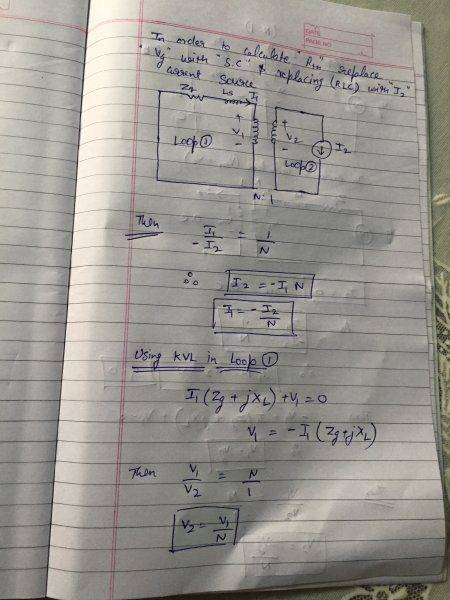

  • Handwritten derivation on lined notebook paper: a transformer circuit diagram with Loop 1 containing Zg and jXL and Loop 2 with a current source I2, then equations I2 = -I N, I1 = -I2/N, I1(Zg + jXL) + V1 = 0, V1 = -I1(Zg + jXL), and V2 = V1/N.

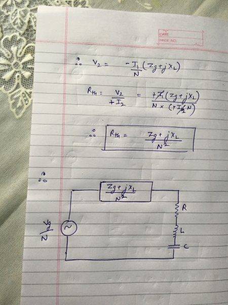

  • Handwritten derivation of the Thevenin equivalent for a transformer-coupled load: V2 = -I1(Zg+jXL)/N, RTh = V2/I2 leading to RTh = (Zg+jXL)/N^2, with a series circuit below showing source Vg/N, impedance (Zg+jXL)/N^2, resistor R, inductor L and capacitor C.

I didn't check your work through, but it's probably just due to an error in your book. You'd want a step-up (1:N) transformer to give a high-voltage source for the cavity.
