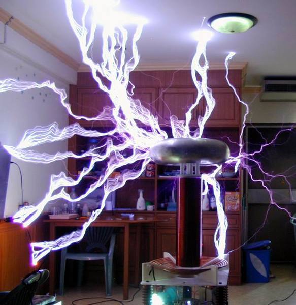

  • #92
Ulysees said:
When a mentor distorts your words in such an obvious way (maybe because he forgot about Tesla coils), what are you supposed to do?
If you hear something that you know to be untrue (eg that mutual repulsion has nothing to do with pins), are you supposed to pretend it's true because you're the OP who's asking?

  • #100
Will you apologise for ignoring the "negatively charged" in the title, because you forgot about the following?

  • #103
.. and how is this relevant to the standard lightning rod? Do you see a belt attached to a lightning rod that supplies charges to the the rod the SAME way as the van de graaf dome? Again, you are mistaking two different phenomena as being the same!
And don't tell me that you actually pay this close attention to such pictures! Really now! If you are ever at Argonne during its open house, try and come visit our Van de Graaf facility. It's WAY bigger than that, and it can accelerate electrons up to 3 MeV!
