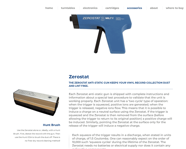

I used to have a red one of these guns back when I still had an LP player (and yes I had the brush as well)... :smile:
https://musichallaudio.com/product/zerostat/
