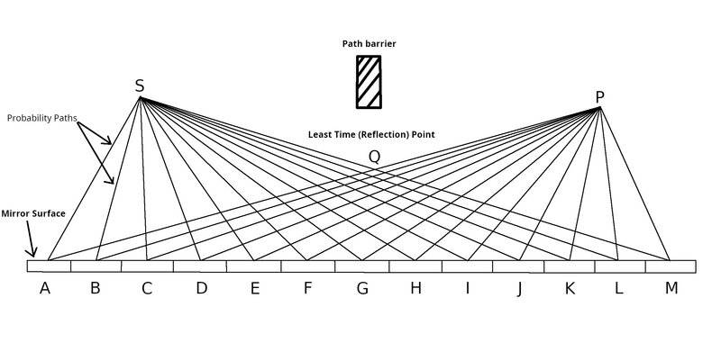

In "QED, The Strange Theory of Light And Matter" Richard Feynman describes the probability path of a single photon emitted from a source, reflected from a mirror surface, and finally reflected to a probe detector. This path is the least time path relative to the probe/viewer, determined by the phasor angle of the time/probability path. See diagram below. Notations added.
As we all know from experience, the detection point is determined wherever the probe/viewer is stationed. Therefore, in principle, the number of possible detection points are infinite in spacial locations, viz., an infinite number of the least time paths are possible. The orthodox particle theory of light would negate such a possibility, but the wave nature of light would seem to allow it. Of course, such detections by eye are a result of many emissions of photons.
But a question arises that, in theory, if we could set up an infinite number of different probes would we detect the same "one" photon at all the infinite probe locations "simultaneously" (ignoring the spatial distance of time delay of the different locations), or is this detection dependent on the finite quantum packet of the photon "particle" and therefore detectable by only one probe? Presumably then, the shortest least action path would be that detection point. Although, this could also possibly be a wave function of a finite quantum packet of the photon.

I can't follow what you are asking. Are you asking for an explanation of Feynman's diagram? Or, asking us to review your own alternative theory to QED?
No. It is all paths, not just the least time path. All possible paths contribute.
I agree with weirdoguy: Feynman is attempting to describe how to do an integration over field variables in space-time on a High School level using little arrows. He did a very good job, but the details are far beyond anything you would understand from High School. My Graduate level (well, perhaps advanced Undergrad) Particle Physics text is very bare bones and it still takes him 200 pages before he introduces how to do this for a very simplified QFT model. (And you already have to know a lot of Linear Algebra and Quantum Mechanics before you could even get there.)
Don't take Feynman too literally here. He is not teaching you how to build a Ferarri ...he's showing you a model of a do-it-yourself go-cart.
-Dan

Actually, yes. A single quantum of light (Fock state, N=1) can be detected in one and only one location - even if there are 2 or more places it could appear.
To perform this experiment, you start with an entangled pair of photons (Fock state, N=2) and detect one of the pair. This means there is another photon somewhere, which is "heralded" by the detection of the first. Then, we look for the remaining one to be detected in one or both of two target detectors where it has been concentrated. You can guess the result (which was measured to accuracy of 377 standard deviations), and here is the reference:
