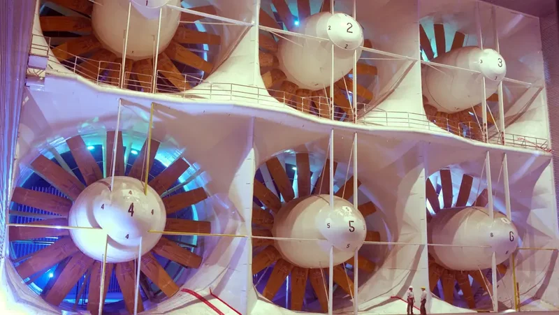

Baluncore's comment is a large part of the answer. It is possible to have powerful air currents on the suction side by simply fitting a duct to the inlet. In fact, the usable regions of some of the wind tunnels at NASA Ames are located on the suction side. This includes the 80x120 foot tunnel, which is the world's largest wind tunnel--it's on the suction side of the giant fans that power the 40x80 foot tunnel.

Put the fan in a duct and the flow rates would be the same on either side of the fan. For the un-ducted fan the closer to the fan we get the less difference between the inlet and outlet side
