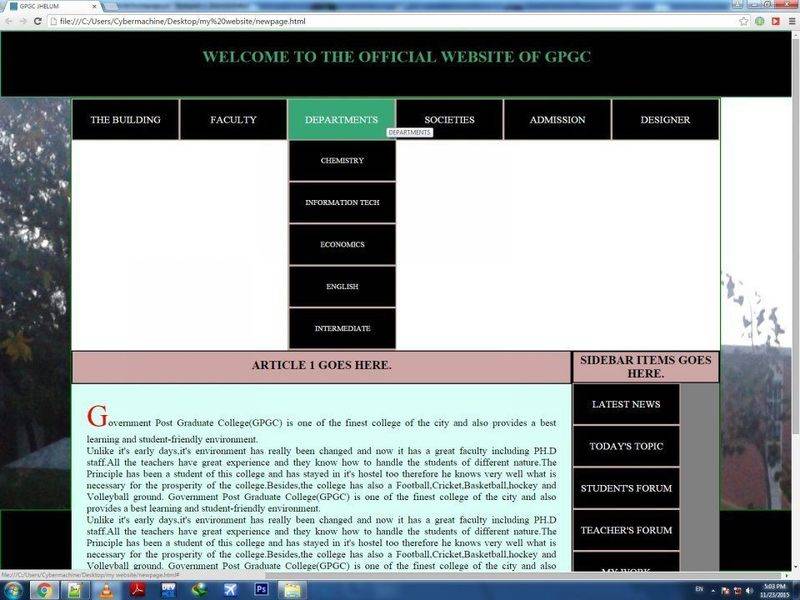

I have Uploaded the picture of my webpage so you can see the drop-down list menu is pushing the divs and other contents down.I want it to be appeared on divs and other contents..

1.Your nav_main has its height defined up to 1000px.
2. Make your popup "visible".
thanks for your reply.
do you have any source/tutorial?
can you please tell me about that as i don't have any knowledge related to css?
i thank you in advance..
And nav_main is the DIV tag ..it's not the nav itself..
Okay, your problem is reproduced here
And this is a fix.
Don't add fixed values of width and height for div's, they just make it hard for you to scale your site components. If fixed values are preferred then table would be better fitted.

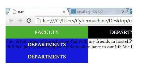

The Problem is solved and the drop-down list does not push the other contents down but I'm having another problem.
I have added a paragraph after the nav menu and the drop-down list is working just perfectly but when I hover the pointer over the drop-down list-item,the list vanishes due to the paragraph beneath it...
What is the problem and how can i fix it?
I'm really baffled with it,please,can you help me solve this problem?
Here is the drop-down list but the list disappears due to the paragraph beneath it..
