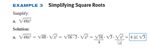

If ##\sqrt{x^2} = |x|##, why ##\sqrt{16} ≠ |4|## instead of 4 (please see below image)?

I mean if ##\sqrt{16} = 4## why ##\sqrt{x^2}## is not x?
Because when x is negative, ##\sqrt{x^2} = -x##

But is ##\sqrt{(-4)^2} = -4##?

Absolutely not! ##\sqrt{(-4)^2} = \sqrt{16} = 4 = |-4|##

What about this?
##\sqrt{(-4)^2} = (-4)^{\frac{2}{2}} = (-4)^1 = -4##
Isn't from the above shows that ##\sqrt{(-4)^2} = -4##?

No, it doesn't.
The exponent properties you are using apply only to numbers that are nonnegative.
##\sqrt{(-4)^2} = [(-4)^2]^{1/2} = 16^{1/2} = + 4##
The rule that you are misusing says that ##(a^m)^n = a^{mn}##, provided that ##a \ge 0##.
