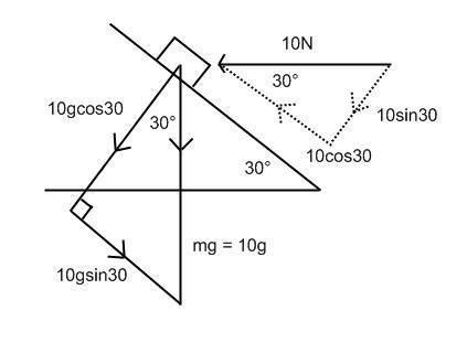

The question is, "A particle of mass 10kg is at rest on a rough plane inclined at 30° to the horizontal. A horizontal force of magnitude 10N acts on the particle. a) Find the magnitude of the friction force on the particle."
URL TO IMAGE (I added the green to help you understand why I am confused): i209.photobucket.com/albums/bb180/newguyjb/forcesdiagram.jpg
The book provides the answer with the working, which is:
F+10cos30°=98sin30°
F=98sin30°-10cos30°
=40.3N
However, I don't understand how they have decided that it is 10cos30°. On the diagram I provided (which is the link) in green the area which is not in the diagram in the book, but which relates to why I am confused as to why it is 10cos30°. Could someone explain why it is 10cos30°.

Hi King,
That equation is the components along the incline of all the forces. What is the angle between the 10N force and the incline? The component of the 10N force that you want in that equation would be the side adjacent to that angle.

You have your force diagram wrong;
or whilst that's waiting to get validated
stopouts.com/pic1.jpeg
Since frictional forces act parallel to the plane and the object's at rest, the force pulling it down the plane must be equal to the frictional force keeping it in place + the component of the 10N force acting parallel to the plane.

Hi all,
Thank you for all the replies :)
I understand how to resolve forces, and from the question I understand that it is F+?-98sin30°, just the ? part confuses me. If you take the slope it is 180°, the forces (one going right and the other going down) are 90°, thus 90° remains as the sum of the missing angles to create 180°. Also, one can calculate that the right-angled triangle on the left has 90°+30°=120° and so 60° remains. Thus, if we go back to where the 10N force is, the angle adjacent to the horizontal must be 30°. And oh my God I just solved my own question. lol!
