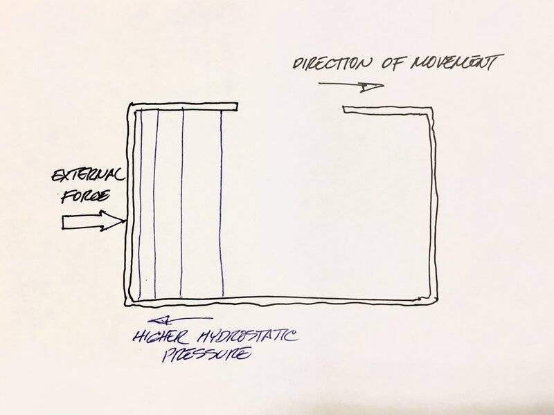

brochesspro said:
... however, if say the container is moving horizontally with an acceleration, this would lead to the conclusion that the free surface makes a right angle with the floor/horizontal, which is clearly wrong....
That would be correct in the total absence of the acceleration of gravity.
For a rectangular container being accelerated by an external force in a direction parallel to its bottom surface, you will see exactly what you see for liquid inside a static container on Earth, only that all would be rotated 90°, including a free pressure and a hydrostatic pressure gradient within the liquid.
If our contained liquid is under the influence of two different accelerations (gravity and lateral horizontal), having orthogonal directions, the angle of the surface, as well as the planes of similar hydrostatic pressures, should be within those two extremes (perfectly horizontal or perfectly vertical).
Regarding the magnitude of each acceleration, the formed angle should be equal to the tangent of the ratio of both accelerations.
When the magnitude of the lateral horizontal acceleration of the container reaches 1 g (a = g), that surface angle should be 45°.
