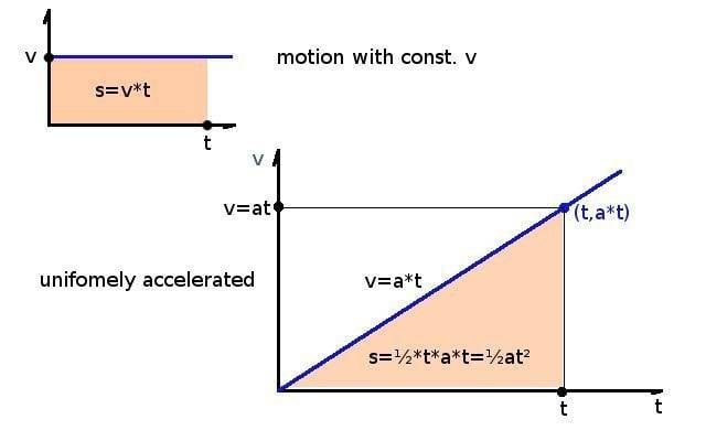

mapa said:
I like to visualize what is happening in my head.
OK, let's show you :)
When you imagine v(t) graph, distans is representing as an area under the curve.
In motion with constans velocity it is clear: v(t) is horizontal line and s=v*t (see picture below)
In uniformly accelerated linear motion v(t)=a*t, so each point have coordinates (t, a*t).
Then area under the curve it triangle. Area of the triangle equals 1/2*a*h where a is the length of the base of the triangle, and h is the height or altitude of the triangle.
In this case s=1/2*t*(a*t) = 1/2*a*t^2 (see image)
regards
  • Two velocity-time graphs: top, constant v shown as a horizontal line with shaded rectangle labelled s=v*t; bottom, v=a*t straight line through origin with shaded triangle labelled s=1/2*t*a*t=1/2at^2.
