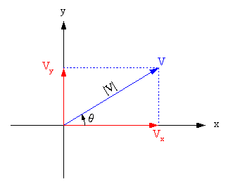

Why are you using the speed from AFTER the collision? Why are you using the cosine function for both components? You want to find BOTH components of the INITIAL velocity (before the collision) for the first vehicle. The initial velocity has ONLY speed 0.0246 m/s at angle 0°. That's all. No other angles or speeds should enter into consideration here.
Perhaps you are unfamiliar with the use of vectors? In the following diagram a velocity vector V is shown on a set of Cartesian coordinate axes. The velocity vector has magnitude |V| which corresponds to the speed, angle θ with respect to the positive x-axis, and x and y components are depicted in red. Use the appropriate trig function of the angle to extract the individual x and y components of V.

Probie1 said:
weight 13158kg
heading 0 deg
departure 179
impact velocity 0.0246 m/s
departure velocity 0.49 m/s
weight 1726 kg
heading 190
departure 245
impact velocity 4.374 m/s
departure velocity 0.91 m/s
Vx = .0246 * cos 0 = .0246
Vx = 4.374 * cos 190 = -4.30
Those would be the x-components of the initial velocities of vehicles 1 and 2. You should give them distinctive variable names in order to distinguish between them. Something like V1x and V2x.
Now, where are the initial y-components of those same velocities?
Vy = .49 * sin 179 =0.008
Vy = .91 * sin 245 = -0.824
Those are the y-components of the final velocities of the of vehicles 1 and 2. You should give them distinctive variable names in order to distinguish between them. Something like U1y and U2y.
Now, where are the final x-components of these same velocities?

No, it's not correct. You cannot add (in that fashion) unlike components; they are vector components. Thus you cannot arithmetically add x components to y components in that fashion. They must be kept separate. You should end up with separate x and y components for the momentum vectors.
They can be combined into magnitude and angle form by employing a bit of Pythagoras:
##|P| = \sqrt{p_x^2 + p_y^2}~~~~~~~~~~~~~~\theta = tan^-1(y/x)##
Watch out for the quadrant of the angle... the arctan function only returns angles in the first and fourth quadrants, so use a bit of thought to place the quadrant using the signs of the individual x and y components. A better choice of function is the atan2(y,x) function which handles all of this automatically, and which you may or may not have on your calculator, or it may have a built in rectangular-to-polar mechanism.
